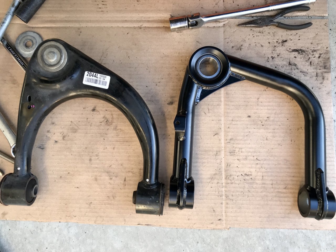

    I bit the bullet and got the pro comp arms for my truck. I got them at a wholesale discount that I can't get on Total Chaos so I can't say much about the guys paying full retail but I was pretty impressed with the quality. Its not like I'm gunna cut into them to test the thickness but they are HEAVY. I deal with tubing at my job, so I can get a pretty good feel for it by holding it and they are pretty damn beefy.
    Mine came with a gusset where the uniball is that is not shown in this photo. The alignment on my truck with 3" of lift is back into factory spec. My alignment guy said he had all the room he needed and more. The install instructions were good enough for me to do it at home with hand tools. The zerks are tough to get to once they are installed but who really cares about that.
    Been running these for about 2 months now and I'm pretty impressed. My tires 285/70/17 rubbed like a mother on the stock uppers but now they barely touch the Pro Comps with stock wheels. I occasionally hit some whoops but don't beat on them every day or do Baja races or anything.
    All in all I'd say these are a good product and the photo in this post doesn't do justice to how nicely welded these things are.

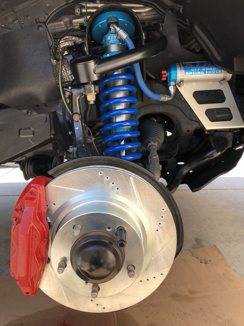

    On my 2015 Tundra I’ve been using Pro Comp UCA’s for 2 years now and at least 20k miles on them. From daily driving, trails, high speed wash boards and some crawling in Anza, Joshua Tree and Nevada they’ve held up without any issues at all. They have yet to produce any unusual noises. I’ve also never had any alignment issues. The shop was able to align within factory specs. I paired the arms up with Kings with external adj reservoirs set at 3in and a Coach Builder .5in shim.
    I was able to purchase the arms for around $550 and couldn’t be happier. Knowing that TC and Camburg are great arms and proven don’t let the name Pro Comp completely deter you.
