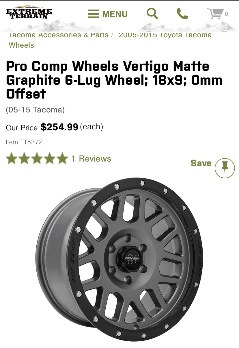

    Anyone have any experience with the pro comp vertigo wheels. I’m doing 2.5” lift and will have UCA’s . Looking at these in same size I have now 18x9 with zero offset. Want to move to a 33” tire.

    Will a 275/70r18 fit with a 2.5” lift and ICA’s without having to chop stuff? It’s a small upgrade from the stock 265/70/R18 that it came with

    It’s gonna be tight. Definitely get out the saw.

    I have the same size lift, offset wheel and a 285/65/18. At first without the UCA it didnt rub at all, im not sure what the alignment was at that time. I Installed the UCA and it started rubbing so a CMC and fender trim was in order. Then made sure the alignment shop gave me positive caster (3.5) and it doesnt rub anywhere except barely at full turn on the UCA with the veryyy edge of the tire. Im not concerned, but i will go 275 with the next set. Good luck

    I don’t believe any Tacoma came with a 32.6 tall tire from the factory. Plus your going to a 1.5” wider wheel which changes the scrub radius and then a 0 offset which adds to that. Once you get the alignment you’ll know for sure. You won’t be able to run factory caster specs with that tire.
