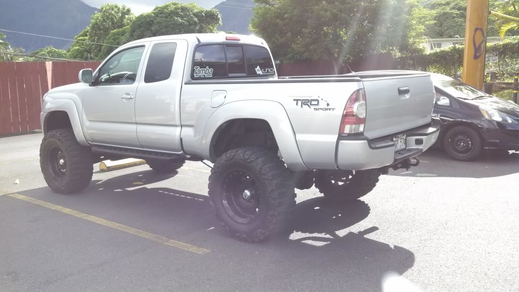

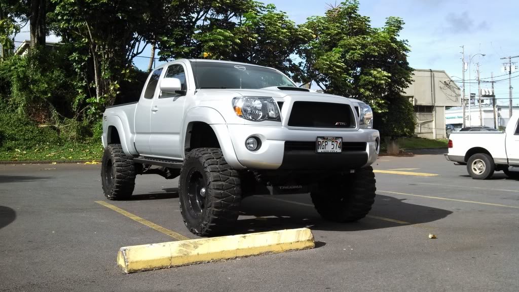

    i got the same lift.... only i built mine to a stage III... urs is a stage I. it will take trimming, chopping some of the frame (bodymount). definitely new coilovers. i only rub a little when i offroad and its only on tight turns and im at about 9 inches of lift now all suspension
    my setup is running 35"x12.1/2"x18s nitto mud grapplers. 7" leaf pack in the back and procomp mx6 adjustable coilovers maxed in the front
