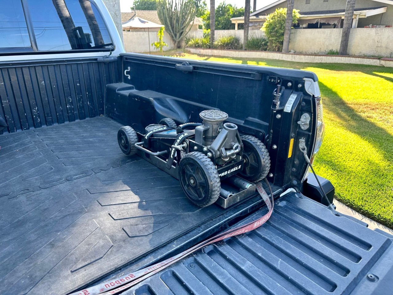

    I just wanted to throw this info out there since I haven't really found anything on TW. I was able to mount my pro eagle jack using the factory bolt locations. A quick trip to the hardware store and $5 later the whole thing was tightly secured.

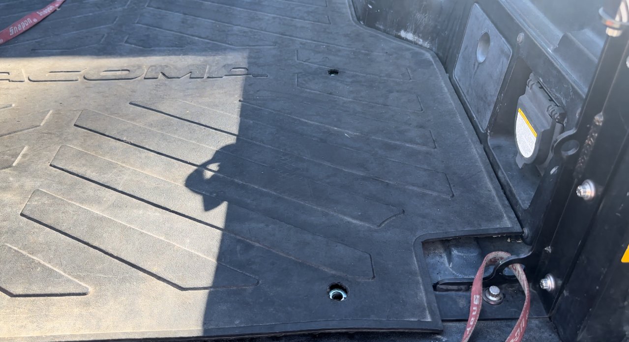

    The front bolt works fine but the rear bolt is too short and needed to be longer. I drilled holes into the bed mat to allow washers to drop through it. That way everything was nice and tight when torqued down.
    Rear Bolt Spec:
    M12x1.25x120mm
