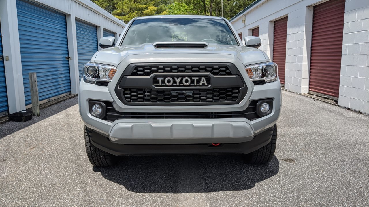

    Hey all, I got the TRD pro grill and garnish (both knock off) and now I'm getting the light telling me the front crash detection isn't working. I double checked all the wiring and it looks good. Do i need to buy the oem garnish to fix this, or is there some sort of reprogramming I need for the new sensor location?

    On my 2018 OR, I moved the TSS from the center of the grill down to the same location as the PRO, when I went with an aftermarket grille. I did not need to reprogram. I will note however, there is only a plain piece of polycarbonate covering my sensor.

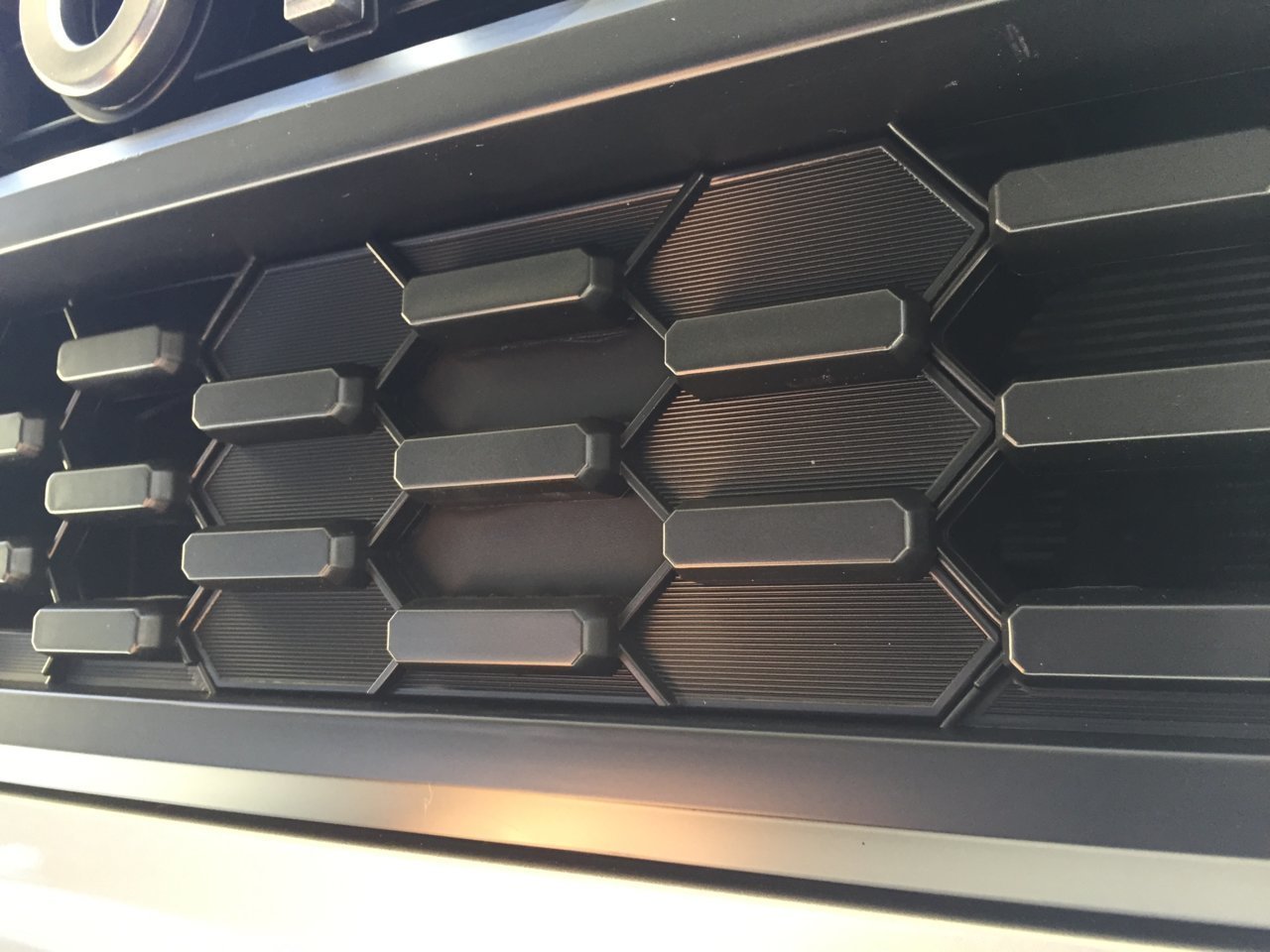

    Are you guys using the OEM garnish? I just put a plastic piece (glued cut piece of a license plate holder) over the sensor and never had an issue. Sensor is looking for consistency (cover) as far as I can tell. I have a 2018
    I have a cheap $100 pro knock off with a spare front license plate plate as a cover....looking for a pic

    Ughhhh. Sorry bad pics before and after. No issues....you just need something to evenly cover the sensor

    Yes, I've only had the light come on twice since all this. One was in some really heavy rain and the other was driving down a really wide dirt road. I didn't do a reprogram or anything like that.
