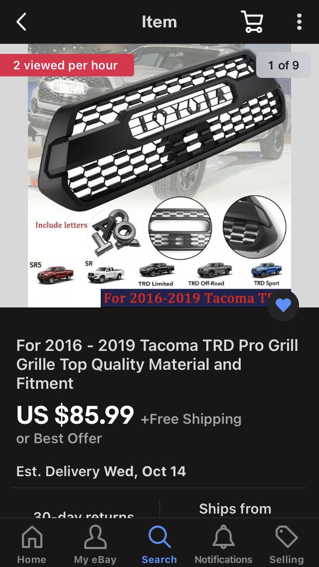

    I just bought a 2020 sport and the first mod I want to do is put on a Pro grill. My question is, I’m looking on eBay and most of the grill say they are for 2016-2019. Will these also fit the 2020’s? I assumed they are the same size but wanted to check first. $85 shipped seems like a great price compared to OEM but will I be sacrificing a lot of quality or is plastic plastic?

    Do you have a front camera? If so, then this grill wont work for you
    Something else you will need to know is that grill does not come with the cover for your front sensor (its behind the toyota emblem on your grill) You will need to buy that separately.

    $85 seems a little too good to be true...Everything I've seen is in the $130-150 range. If you get it and it's not trash, by all means, come back and boast... so I can then go order one.

    thanks for the reply. No front camera. Yeah, I know I need the garnish

    Then it should work just fine. The only change to the 2020 pro grill is a spot for the camera, and if you dont have it, then no worries, you can use the older model grills too.

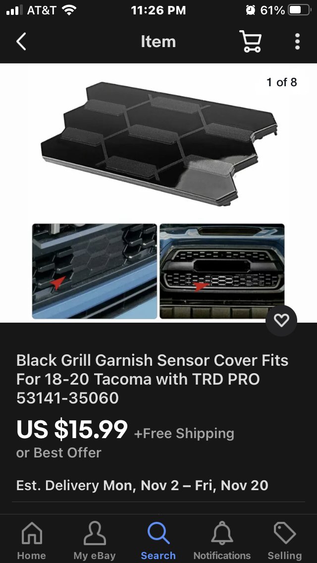

    Most aftermarket pro grills out there are a fair price. Where it starts to get expensive is the tss sensor garnish. It’s the most expensive 5 dollar piece of plastic I’ve seen.

    are you talking about this?

    The oem one is very expensive. Used to be like 30 bucks I thought.
    A lot of people have good luck with aftermarket ones, some don’t.

    With the after market garnish its hit or miss. Some throw TSS errors and some don’t. I would say a 16.00 one may or may not. Most of the decent after market ones are in the 50 range, but then again most of the aftermarket pro grilles are in the 125-150 range

    I'd personally buy from reputable site (R4T, Tacomabeast, ect.)those eBay prices seem too good to be true imo. I paid around 170-180 for my aftermarket grille and garnish and didn't have any TSS problems. Good luck!

    I got my aftermarket pro grill from madhornets.com. I just passed 30,000 miles on my 2019 TRD Sport and the grill has worked fine, since the TSS system 'learned' my driving, etc. This sense that some aftermarkets sensor covers don't work well, is a misnomer. It is NOT the sensor cover, but the fact that the system has to learn. Yes, itis annoying to have the dang PCS System OFF light come on for seemingly no reason, but after a while, it settles down and works just fine. It took me about 9000 miles for it to finally settle down so the PCS OFF light doesn't come on anymore. Like I said, I now have over 30,000 miles with no problems since passing 9000 miles.

    It will fit right BUT the garnish might not fit right. I bought one and where the garish goes was different. I had to mod it for it to work and it ain’t pretty. See if you can get a good view of the back where the garnish goes...
