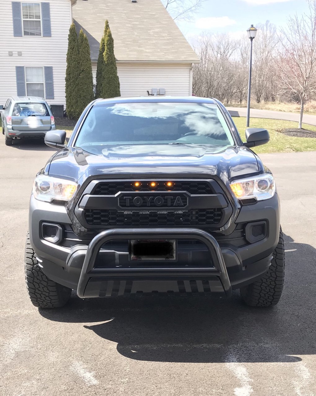

    I bought very similar lights to these and was just wondering how exactly you mounted them behind the grill. I was looking today and couldn’t see anything that immediately stuck out to me for a mounting point. Any help would be greatly appreciated. Thanks!

    Note small holes at top of grill
    I ran the wires through the channel at the top and behind the grill. Behind the top of grill, there are small openings you can run the wires through. I connected the lights to the driver side amber light.

    Okay gotcha thanks! I’ll look up a video for that wiring. Did you just use like an L bracket to mount the lights to the back of the grill or some other type of bracket?

    No brackets needed. The led lights come with washer and nut. I drilled hole through grill and attach with supplied washer and nut

    Got mine all mounted up yesterday. I was tentative about drilling into the front of my new grill so I used a couple cheap brackets from Home Depot to mount my lights up. It was pretty easy and I love the look.

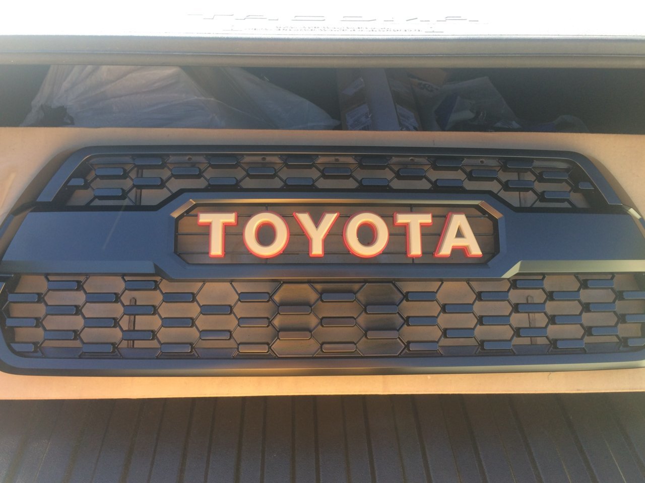

    Where did you get the pro grill from?

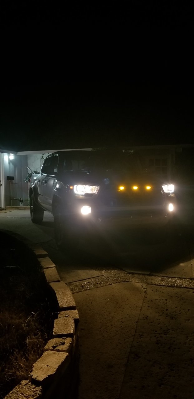

    Here's a pic of my Runnin4Tacos.com ones. Super bright!! 20190225_212130.jpg
