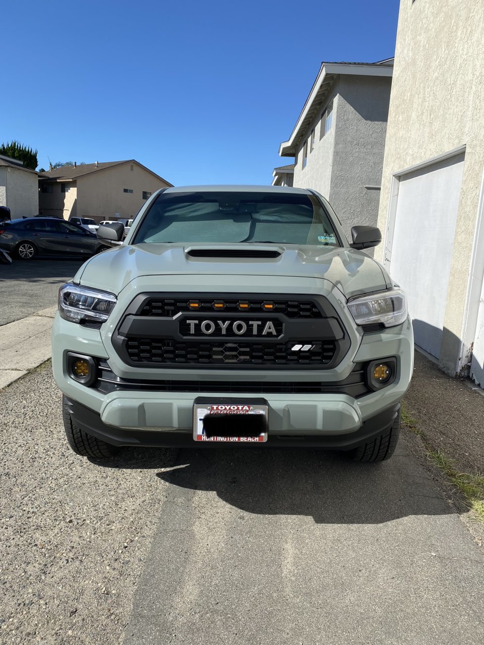

    I recently upgraded to the Pro Style Grille and since doing so, I am having the TSS issues. The light that indicates that the PCS system is off illuminates and when I attempt to set the cruise control I get the warning beeps/amber triangle. I purchased the grill on Amazon from a link I found somewhere on here. Seems like a nice grille and the TSS garnish was included, so I am sure it is not OEM. Here is the link to the page with the grille I purchased
    https://www.amazon.com/ANGUMI-Replacement-Grille-TSS-Cover/dp/B09WJY9DPV?ie=UTF8&th=1
    It seems from what I've been reading on TW, some of you have had no issues after installing one of these grilles where others have. Some have had problems using the aftermarket TSS Garnish where others have not. So I'm trying to figure out what might be different on those trucks that have installed the grill and had no problems and those that have had issues.
    I've tried the washer under the screw tab trick with a .75mm washer, then a 1.5mm washer then no washer at all. No luck.
    I have also read that the system will relearn (basically self calibrate) after installing the grille and eventually the problem will correct itself. I have some doubt about that myself, however was wondering if any of you can confirm that the system does, in fact relearn itself, and if so, about how long it normally takes to do so.
    Lastly, I wanted to ask if any of you who have had success in installing one of these grille (no problems at all) would be willing to take a close up pic of how your TSS garnish sits in the grill so I can compare it to how mine sits. Mine seems to be recessed into the grill a little more at the top and sits almost flush with the grille at the bottom. This leads me to think the garnish is not sitting correctly.
    Also any other suggestions would be appreciated before I say F it and put the old grille back in.

    One of the things you might consider as the problem is the garnish. Aftermarket garnishes can be hit or miss....some work fine, some are problematic. The one I got from Taco Vinyl was shipped installed with the grille and worked perfectly from the get-go. No washer, no re-learning, no codes. Don't know about the ones from Amazon. Best thing to do is to search and find a source for garnishes that people have found reliable. You could also hedge your bet and get an OEM garnish, but prepare to bend over at the dealership parts counter when they invoice you.
