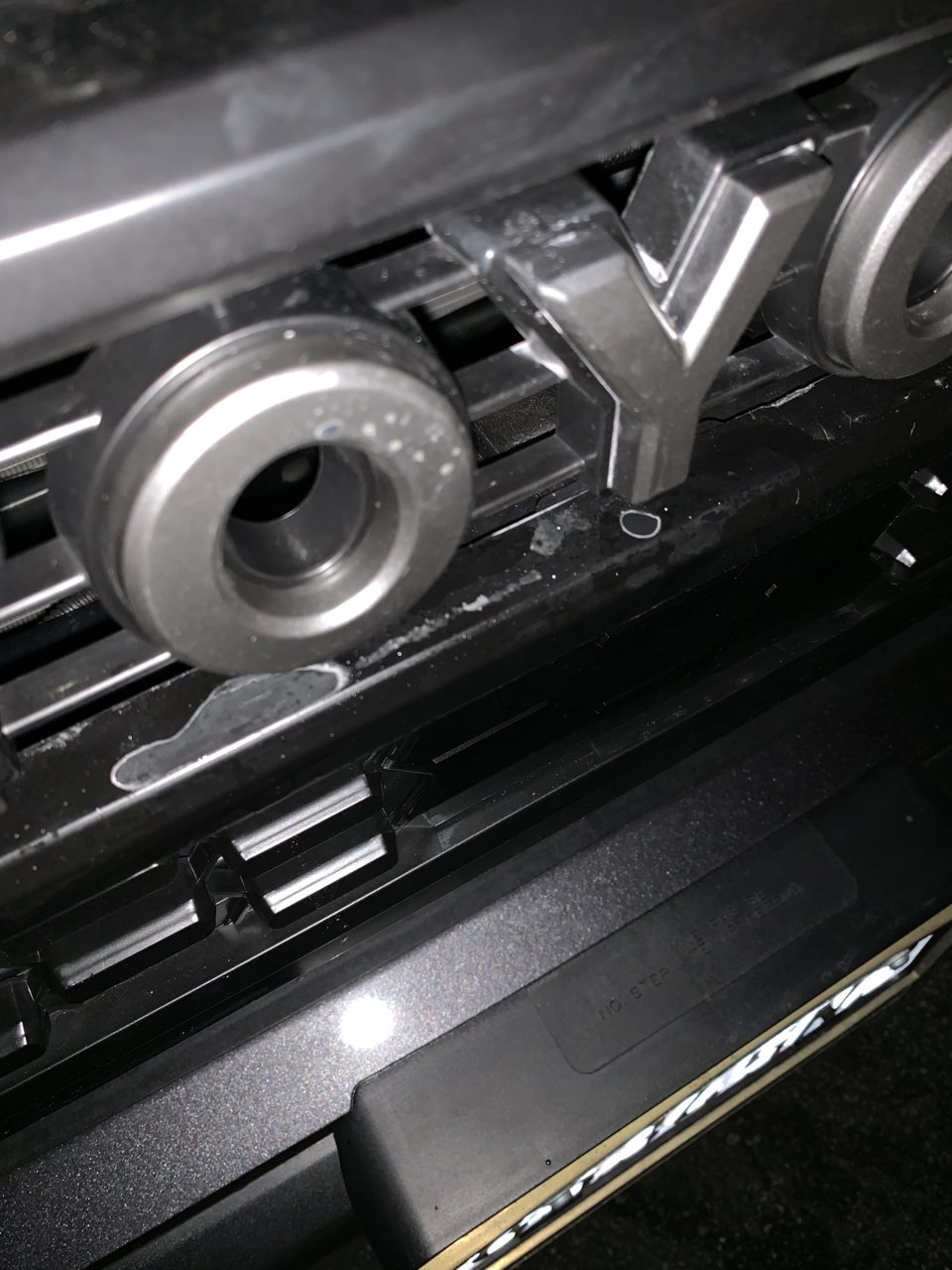

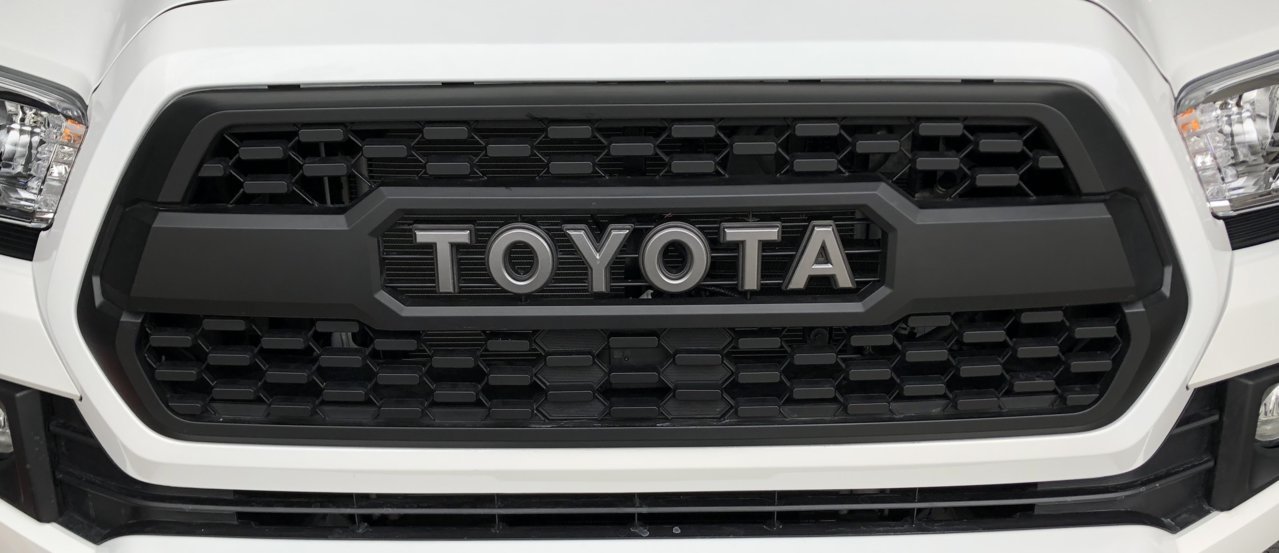

    1 day of hard rain and this is what mad hornets got me, not to mention the Y letter fell off within days, along with the defects and bumps all over the plastic - stay away from them.

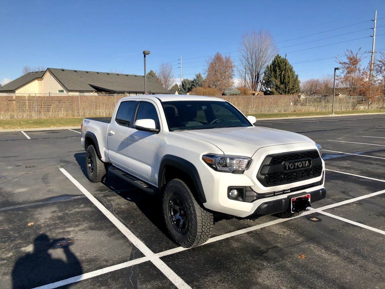

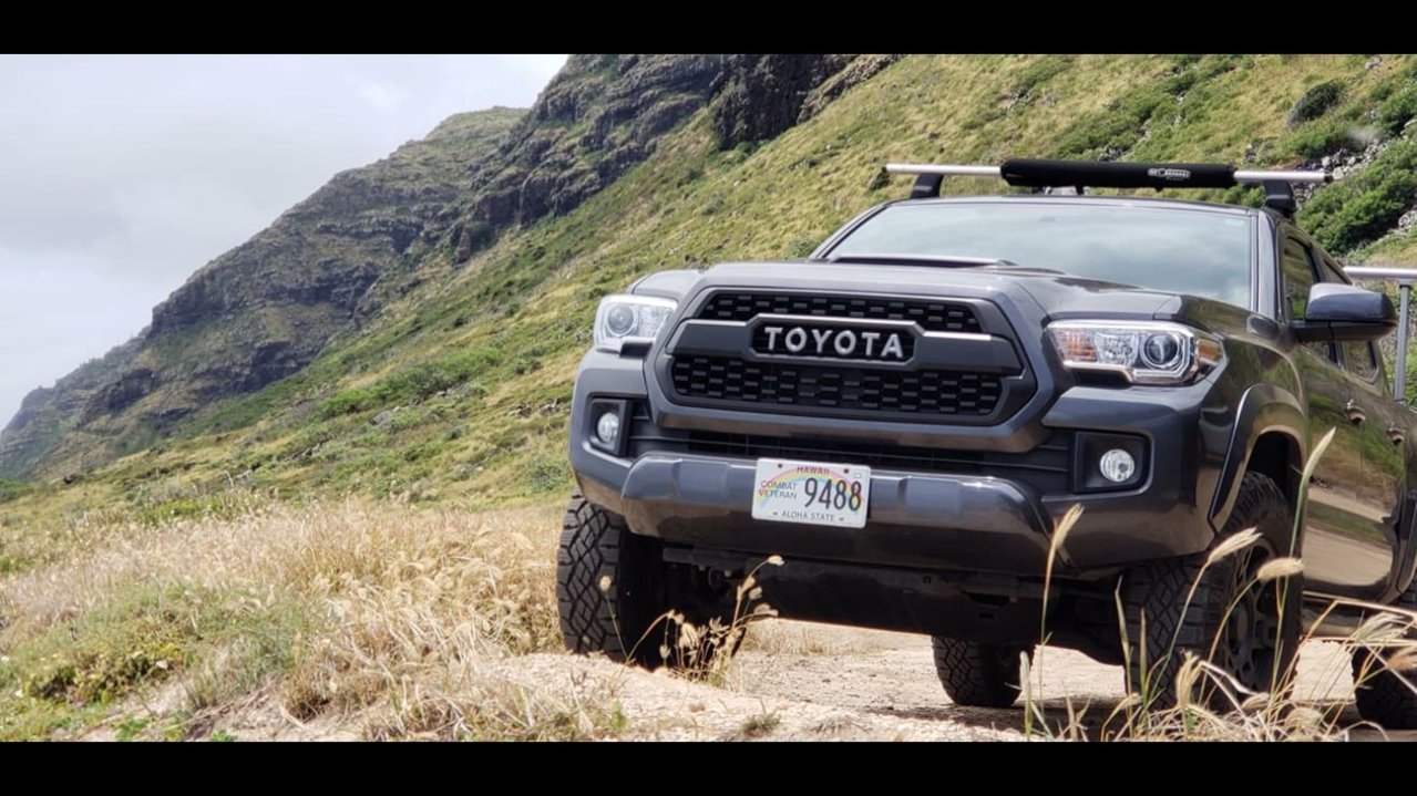

    Fake, one hundred percent.

    Yes fake

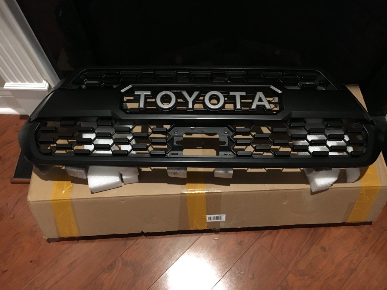

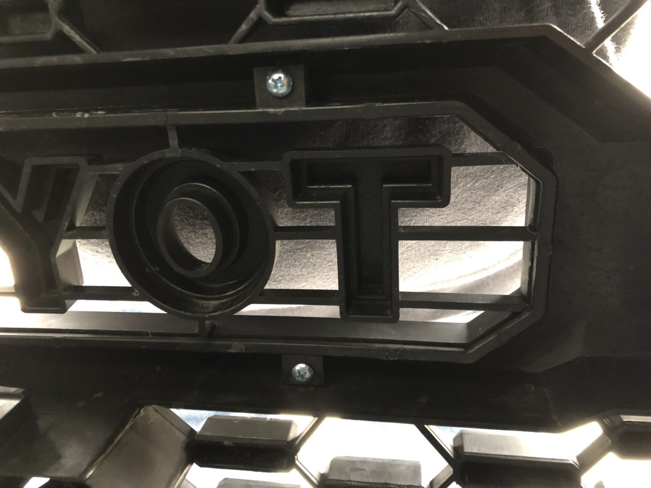

    I got lucky with my $73 eBay grill. No taping letters on or attaching a random letter. Only 4 screws to attach the TOYOTA to the main grill. No garnish either and TSS works normal after getting the clean sensor error for 100 miles. Sensor had to adapt to the new obstruction in a slightly different place than stock grill.

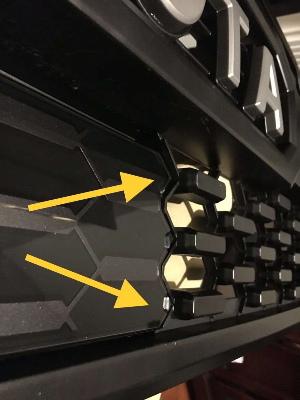

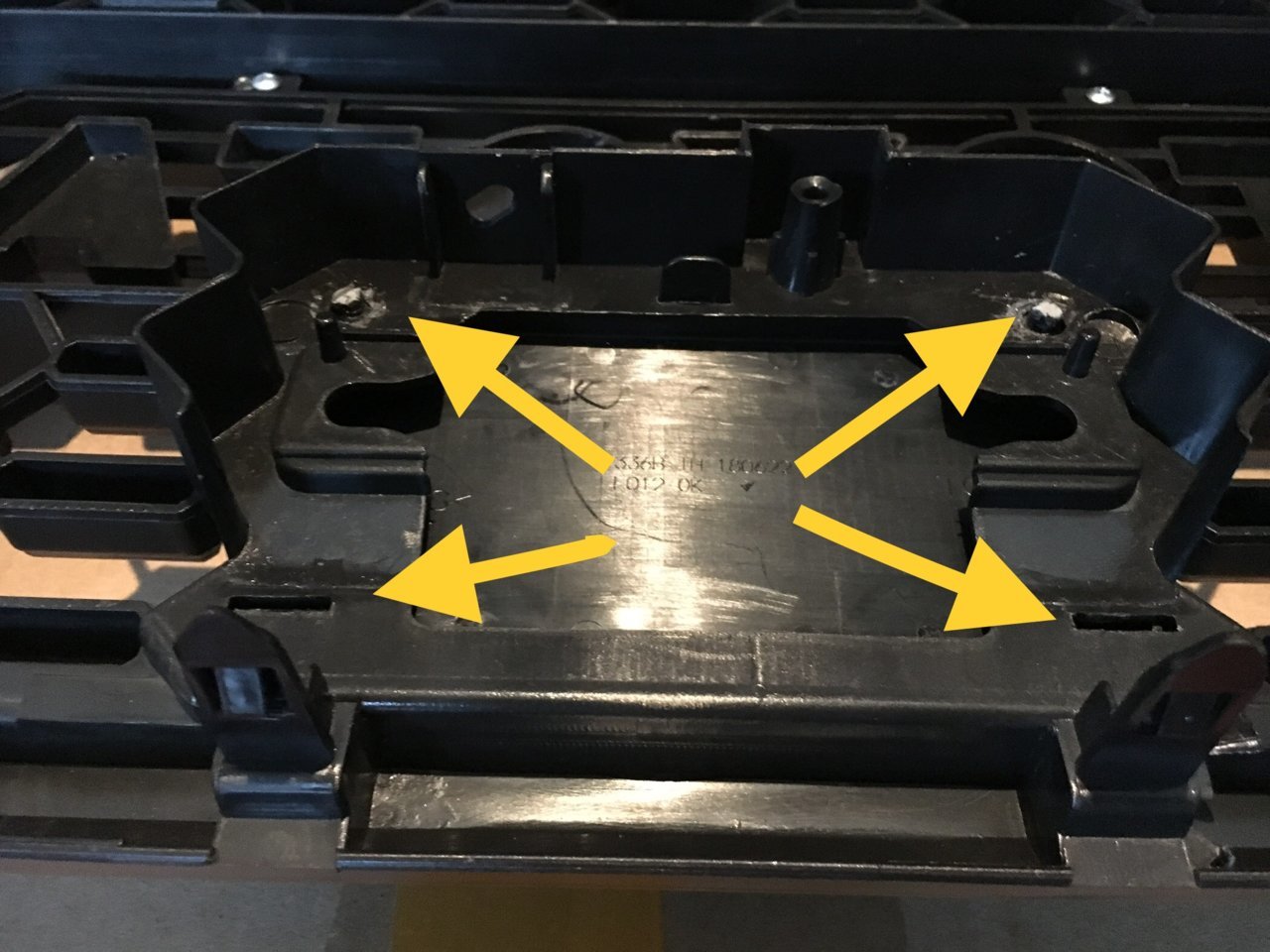

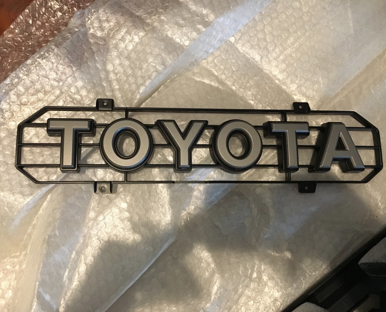

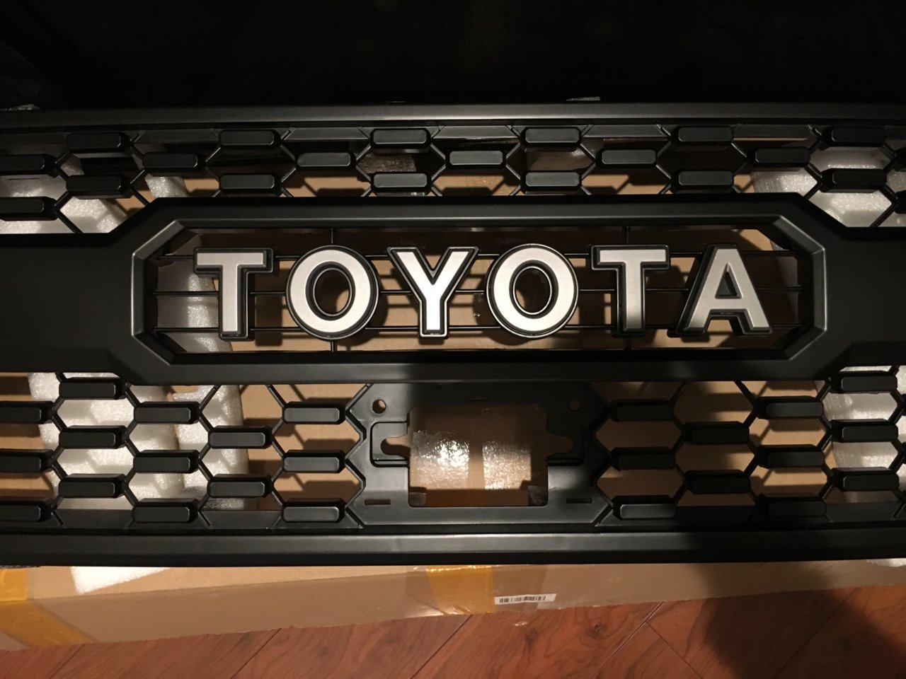

    After much debate, I ordered a $73.99 Pro grille via Ebay. It arrived as a two piece set. The fit and finish is far better than an Ebay grille I ordered and installed on my previous ‘17 Tacoma.
    The “TOYOTA” insert needed to be screwed to the rest of the grille. Four screws were included in the shipment, but two were too small. I picked up larger screws at Lowes and used them to hold the insert firmly in place.

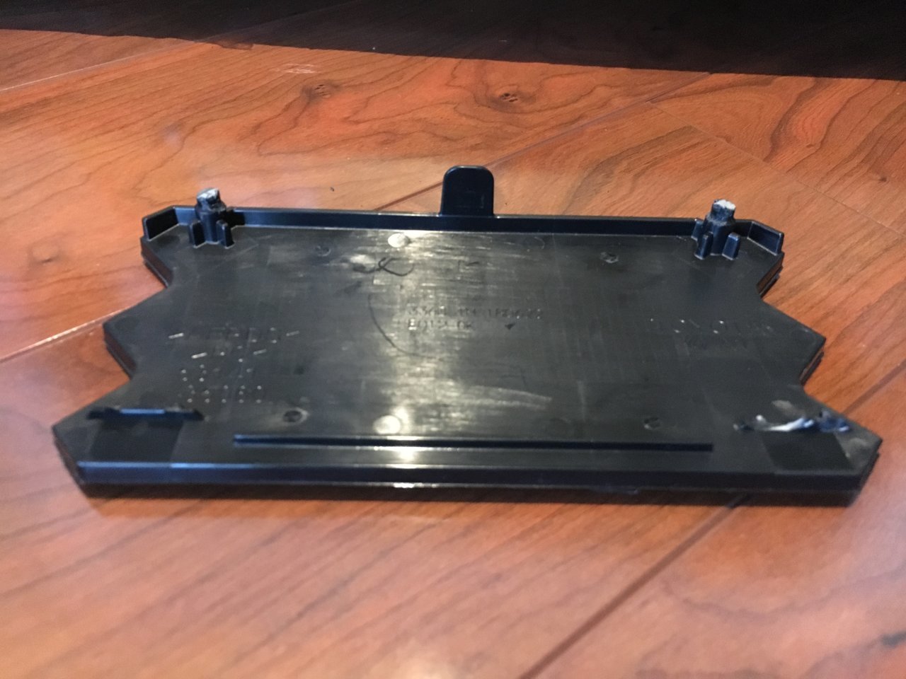

    The next issue I encountered was the OEM garnish did not line up flush. I tried to maneuver the garnish to get it more flush with the rest of the grille, but ended up breaking the two lower tabs of the garnish. I also broke off the studs at the top of the granish which were held in place by lock nut washes. I’ll probably try to use epoxy to hold the garnish in place. Overall, I’m extremely frustrated.

    That one is.....real. I now have a fake one on due to me breaking the real one and not wanting to spend the cash on a real one again lol.

    No for real I whacked my first one with my long board really good and it cracked lol.

    Just kidding that shits faker then Gucci on canal street. Had you going for a second though.

    I used J-B Weld epoxy to hold the OEM garnish in place after breaking the tabs and studs on the back of the garnish. It was my first time ever using epoxy. I think I got it right. Yet another frustration, the OEM screw to mount the top of radar to the grille didn’t work because the size of the hole is too big. In haste, I went without the screw. I’ll find a larger screw and replace it tomorrow.

    My grill attaches the same way however the screws weren't included. Did yours come with them if now what size that you us?
