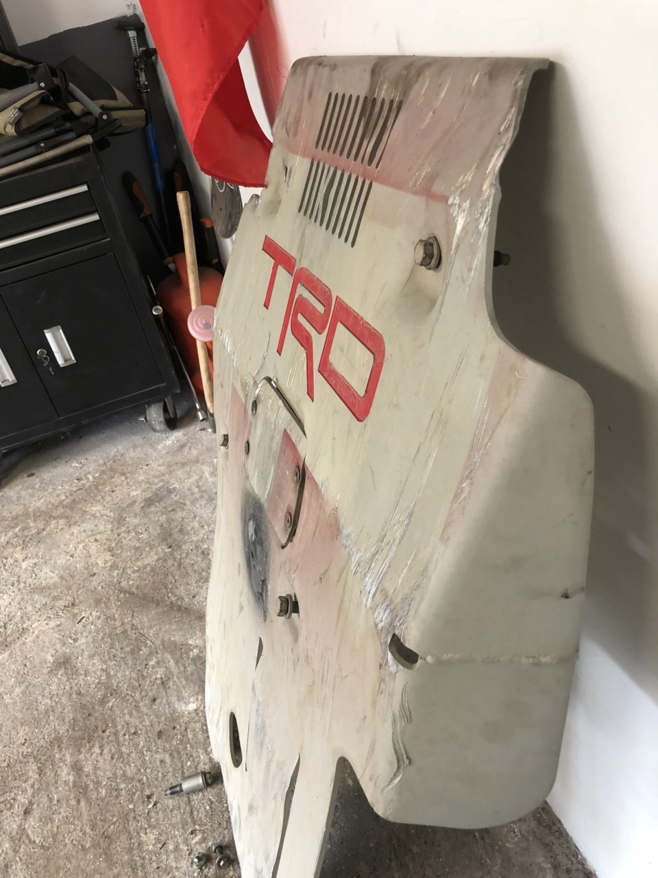

    The OEM skid kinda sucks. Bent mine pretty easy. Looks great when new, but if your really getting serious about going off road you'll want something else.

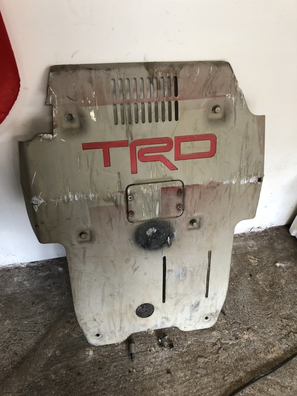

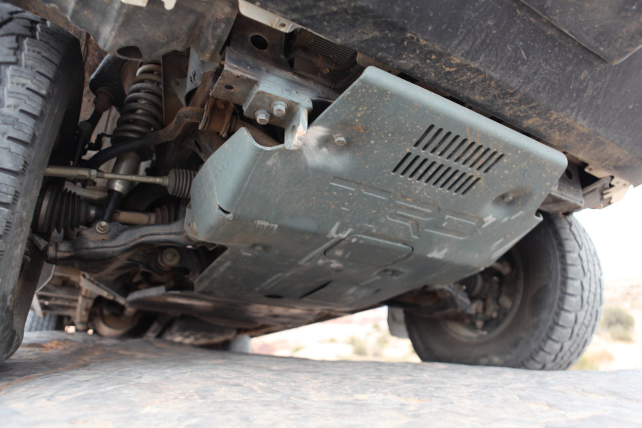

    It can handle abuse and if you can reinforce it, you can take it further!

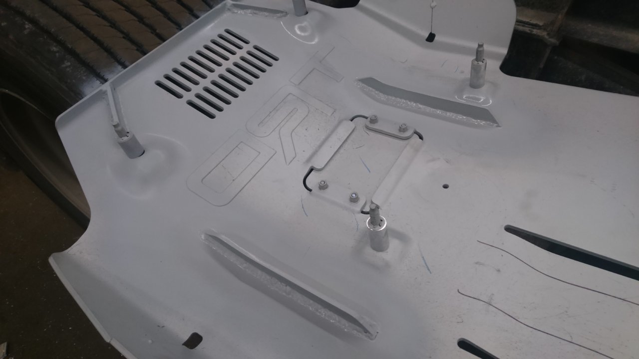

    This was the first skid to see where the most bends will occur :crazy:
    Then got second skid and reinforced it in those areas, no problems or bends since then!
    hrivera007 and cipherbreaker like this.

    Your pictures are why I have a Pro skid on my truck right now. I thought well shit if it can take that abuse then what I do won’t hurt it at all.

    Great idea. I have some aluminum 1/4 inch flat bars at work. Might have to do the same.

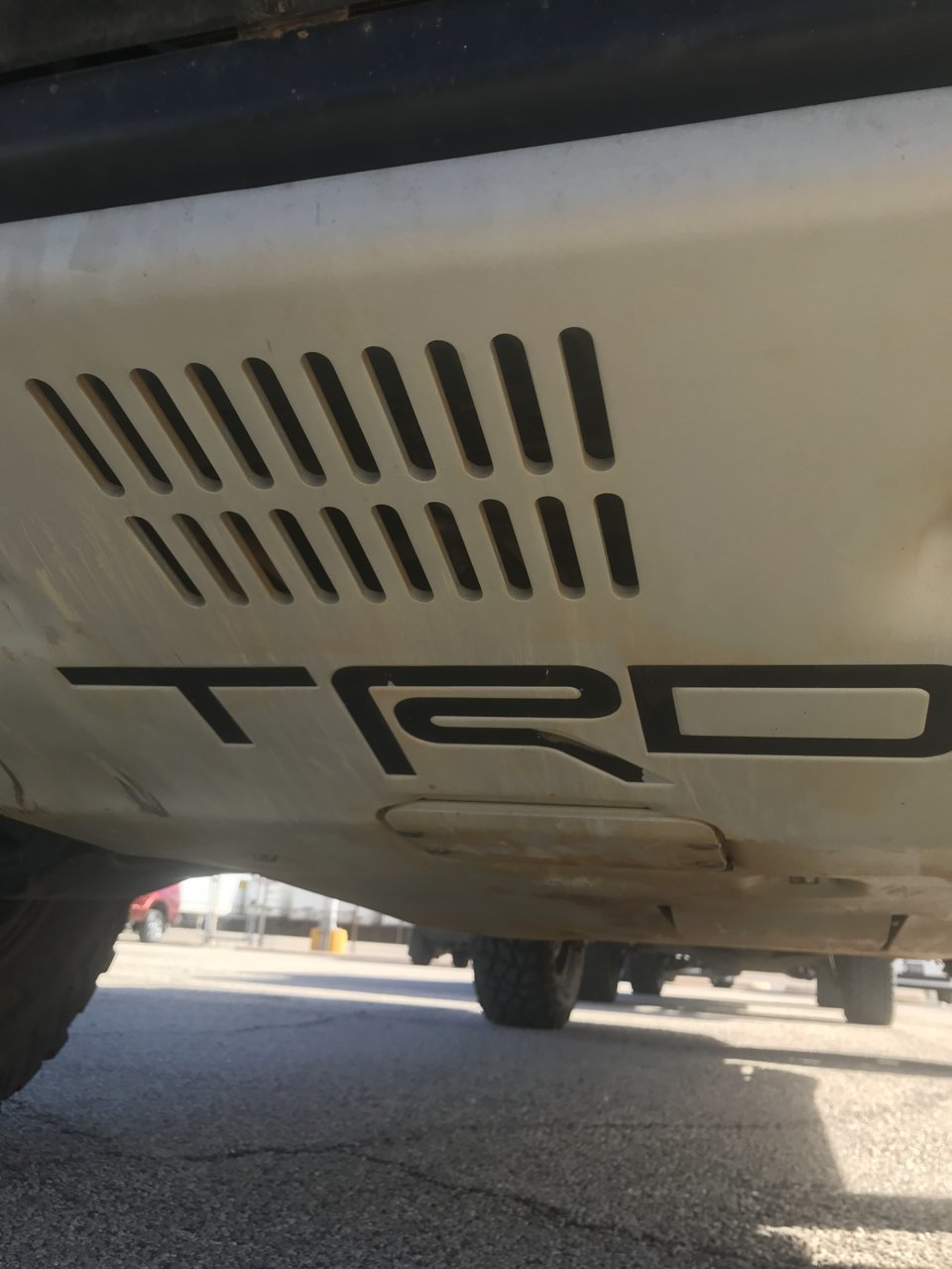

    It can take some hits. Plan on switching to RCI one eventually got this one on the cheap because customer return. All my other skids are RCI. E78B2E5B-0EFF-46B0-A546-D05BF19989BF.jpgBCAE9E9F-A005-4C4B-AD9F-9DD53F53E3D5.jpg E7552301-AC42-4C90-B863-A762FD387AFA.jpg
