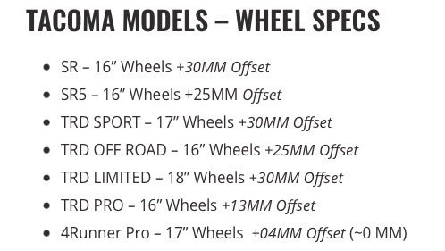

    The offset on the Pro wheels is also +10 instead of the OR's +25, that also makes a difference in the stance. I installed the TRD Pro Fox suspension with 1/4" spacer and I was pretty much level. The appearance difference wasn't as noticeable as when I added 1.25" Spidertrax wheel spacers.

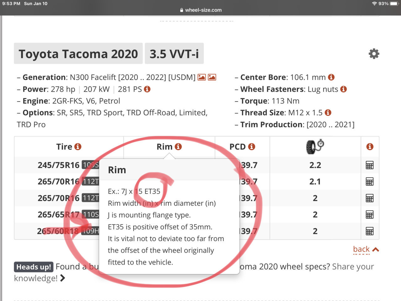

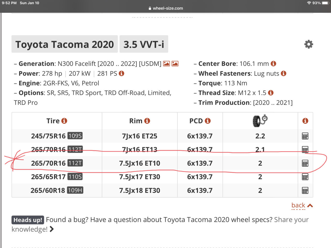

    Looks like we were both incorrect. But, even as +13, the offset still does make a difference in the way the truck's stance compared to the OR +25 offset.

    I have 2020 Pro wheels which are different from the 2019. I am going to assume this is for all Pro models?

    The 2020 has a new style wheel that is a +10 offset instead of the +13 from previous years
