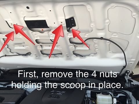

    I wanted to create the PRO style hood vinyl(imitation is the best form of flattery..right??) But I couldn't find the exact size decal...so I made my own.
    Also, It also helps cut down the glare.
    Here is what I used:
    -Avery matte black vinyl ~$20
    -Finishline knifeless tape ~$20

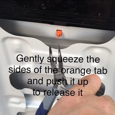

    1)Pop the fake SKEWP out(4 10mm nuts and an orange clip)
    Then I used blue masking take to define the OEM lines.
    Finally, used the knifeless tape(green stuff) to trace the outline
    2)Lay down the vinyl. Go directly over the outlined tape;
    3)Now the magic happens! Pull on the green tape and it cuts the vinyl while creating a perfect line
    4) wrap the scoop, and re-assemble:)
