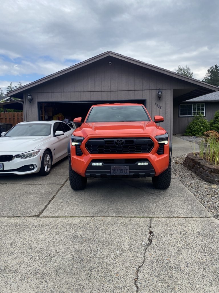

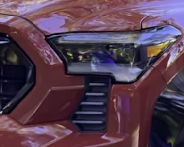

    Hey everyone. I just recently bought some TRD Pro headlights off a nice guy who installed alpharex headlights on his Pro. I installed them onto my 2024 TRD Offroad base and they are plug and play. I saw numerous sources saying you needed a special harness, adapters, or reprogramming. You do NOT. These use the exact same sockets and piggy back connectors.
    Sequential signal works perfect. DRL and all. If you can find them for a good deal I’d say they’re worth it. Looks especially nice on my Solar Octane. Pretty sure Toyota designed them this way as eventual late base model years will get them just like the last few years of the third gens.

    Right. A lot of chatter about a special harness or reprogramming tool needed but after looking at the diagrams provided by Toyota on the parts website… nothing was different. And wazza, they plug and play!
