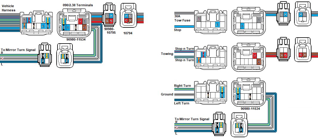

    Probable because I've yet to verify the securing location of the relay on older models.

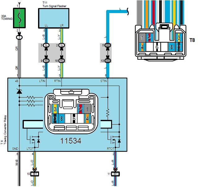

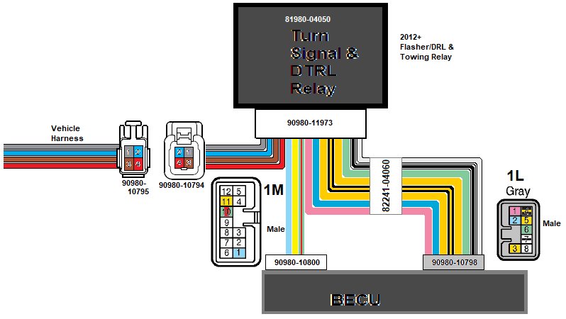

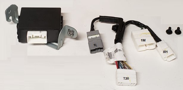

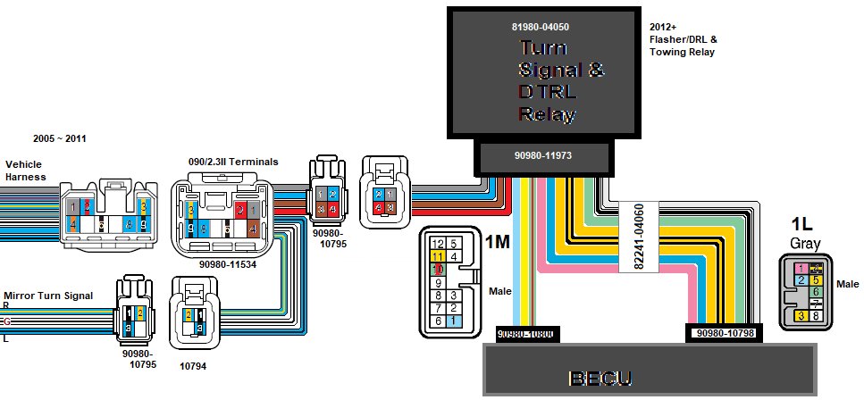

    2005 thru 2015 have the connectors 1M & 1L. Instead of T20 they may have the turn/Haz relay only or connector T11 towards the Turn/HAZ & DRL relay.
    2005 thru 2011 have connector T8 which attaches to the Towing Relay Converter.
    2012 has the towing converter integrated.
    By assembling a harness to tie into the T8 connector the 2012 version can be used.
    2012
    Harness that provides Towing fuse power to the relay and stop signal input and ties into the towing TURN/STOP Left and Right.
    For those doing a retrofit of door mirrors signals, the harness below can be assembled to tie into the turn signals of connector T8 that is available.
    And broken down...
