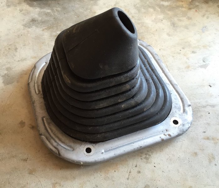

    Hey everybody,
    I've got a fairly simple issue here. My 2000 Taco 5 speed manual will not stick in 2nd gear. It was never much of an issue for me, but I've recently come to a position where I need to sell the truck and all my potential buyers seem convinced the transmission is about to explode because of it.
    I finally decided to see what the problem was and realized that the rubber accordian-style boot is pushing the transmission out of gear. I'm assuming it has hardened with age.
    As soon as I take the boot off, the problem goes away entirely. Put the boot back on and it won't even stay in when the truck is turned off.
    Curious to know if anybody else has had this problem? ...if so, did you simply replace the boot with an OEM boot or did you go with an aftermarket part?
    Thanks!

    The rubber boot is there to seal out wind, dirt and water from the cab. The leather boot doesn't seal. You will get a lot of air and dirt infiltration around the base of the console and shifter shaft without the rubber boot. If your transmission won't stay in gear with the boot something is wrong inside the transmission.

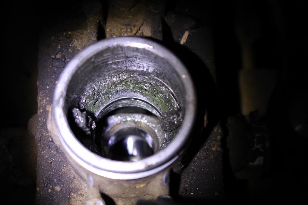

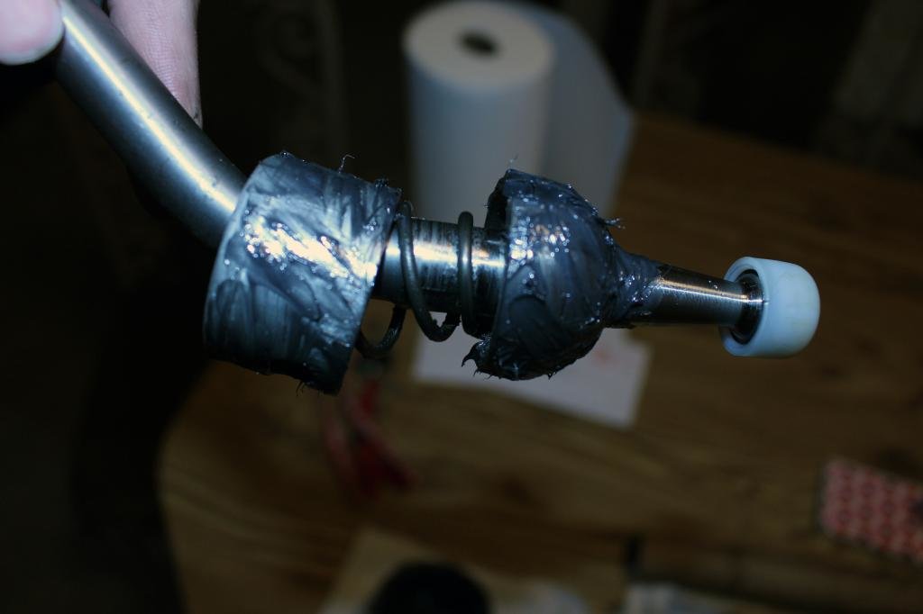

    A very common issue for these transmissions is for the shifter seat to wear out and not leave the shifter handle at the right height to properly engage some gears. I changed mine when my 3rd and 4th decided to pop out. Also to remove misinformation the rubber accordion boot does nothing but seal the outside of the cab from the inside, there is even another soft rubber boot under that one that seals the shifter stick to the transmission housing.
    The shifter seat you need to replace is pretty easy to get to, here's a write up on how to replace it...
    http://www.instructables.com/id/Toyota-Tacoma-manual-transmission-pop-out-of-gear/
    And here is a better quality replacement part... (you need the white shifter seat)
    https://www.marlincrawler.com/transmission/shifter-parts/heavy-duty-seats
    Here are some pictures of how dead mine was after 21 years (barely recognizable as a bushing)...
    And one of the shifter assembly all cleaned and lubed up ready to go back in the tranny...

    Alright, good to hear somebody else has replaced the boot before.
    Ah yes, the bushing and seat. I attempted that fix about 2 years ago with OEM parts, but I need to go back and do it again with the Marlin parts as I think I messed something up the first time (as simple as the job is).
    I keep forgetting to include this info.
    One more relevant piece of info, it has a body lift. The pitch of the shift lever toward the rear and the lower position of the transmission w.r.t. the shift boot can't be what the engineers planned for.

    Well I popped the ribbed shift boot off today and it's shifting great. Strange that I've been driving it for four years and just now took the time to really figure out what it was. Thanks for the help, guys!
