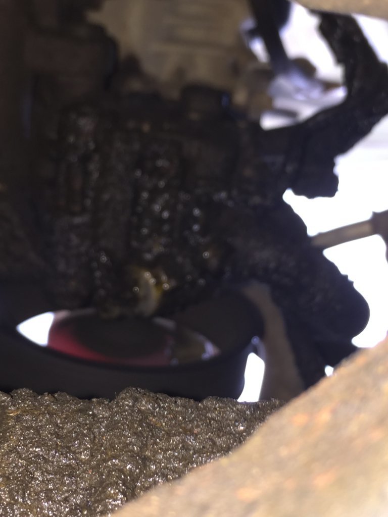

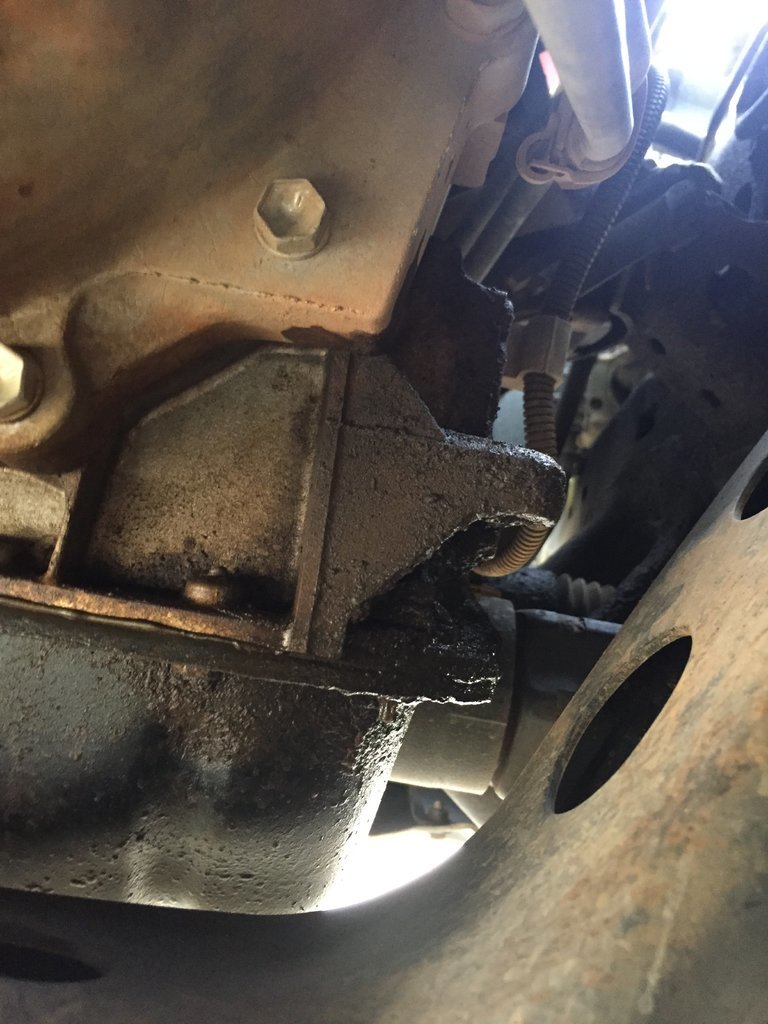

    Possibly. Not something that was leaking from the boot at the time and I didn't open up the power steering fluid to check the level. Not something that is very noticable laying under the truck which is what I did mainly checking the frame.

    You could also have an oil leak from the timing chain cover. Common on the early 2nd gens and I'm not sure what year they ironed out that issue.

    You can put some uv tracer dye in your power steering, drive it for a while then get a black light and the yellow glasses and see where it's coming from.
