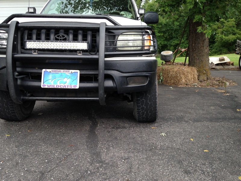

    Was driving today and suddenly had both my front wheels wobbling. I put it in park and looked at them and both wheels are bowed in. I have blistien 5100s 3in and think it may be the ball joints in it but honestly idk. Anybody had issues with something similar?

    Wouldn't say I'm the most mechanic savey guy but I know a bit. I was on a trip and so had to leave it behind till later. I think it's ball joints.
    Pic is the best I could do cause I had to get back on the road and didn't think of taking one

    yea, take the wheel off and take some pics. hard to see from here other then yea, something isnt right.

    outer tie rod snapped and inner tie rod was shot together. idk what did it but a lot cheaper than i was thinking

    tie rod would not camber the wheel like that.
