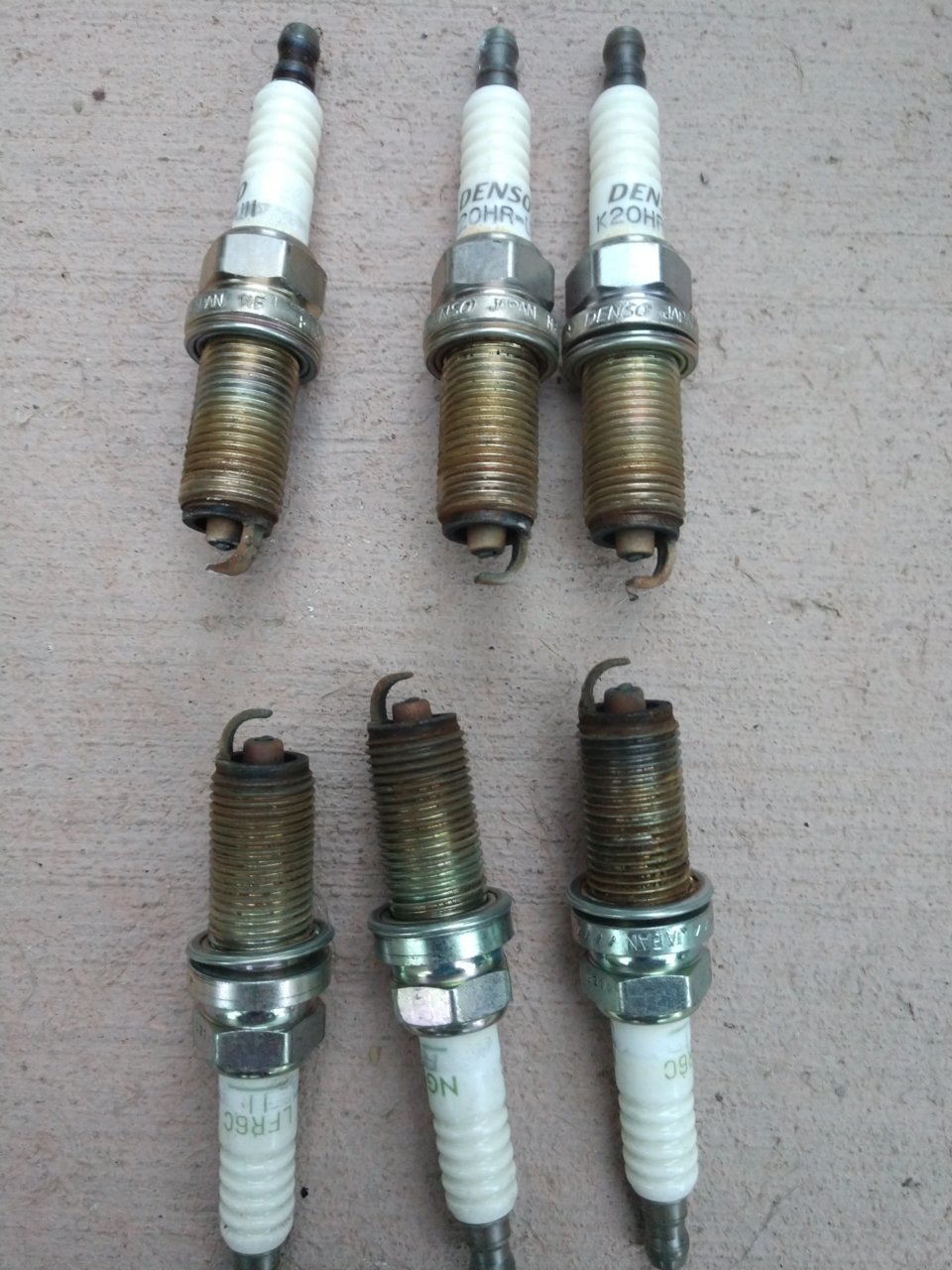

    Hey... just wanted to say thanks for all of the feedback and suggestions. Like it frequently happens, things looked clearer in the morning. I was able to get the connector on by working it over the top and by making room by pushing the wiring harness back. I thought I would share pictures of the sparkplugs as I've never seen plugs this worn down. As you can see the electrodes are worn down into the sparkplug body. Just for fun i measured the gap and it was .090 or more than twice the suggested gap. I'm wondering if they have ever been changed since there's 3 ngk and 3 denso which is how they came from the factory. It has 203,000 miles on it. I bought the truck a few weeks ago and drove it 60 miles home and probably another 30 around town and it actually ran ok. Of course now it runs great in comparison.... thanks again

    Those are originals. :thumbsup:

    Yes they are.
    OP, if you wonder how we know
    It’s because there are 2 different plug brands.
    3 of one and 3 of the other

    203k miles on the original plugs. Wow.
    Believe it or not, I’ve seen worse. With the side electrode completely worn off.
