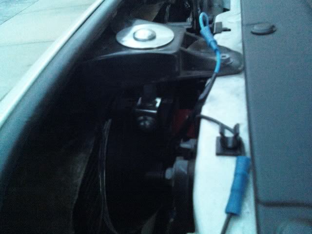

  11. Feb 23, 2010 at 11:47 PM
    1BlkT
    1BlkT Mod'n on a Budget
    Oct 29, 2007
    #3283
    1,289
    Ty
    90603
    2006 Black Sport Double Cab
    Allied 4'' Spindles, Sway A Way 2.5 Coilovers, Donahoe Remote Reservoir Shocks w/ Deaver 11Pack Leafs, Goodyear Duratrac 285's, Pro Comp Series 8128, Recessed Grill w/Hella 500's behind, Tint, Black TRD Skid Plate, Debadged, Tailgate Hose Clamp, Weathertech Mats, Aero Turbine 2525XL Exhaust, Volant Intake, RETRO'D Headlights by Yosh2000
    Ray you get this figured out yet? What are the specs on the lights as far as size wise?
    It's hard to tell in the pic but you can sort of get an idea of what we did.
  12. Feb 24, 2010 at 2:07 PM
    RAD
    RAD [OP] RAD Vendor
    Apr 5, 2008
    #5762
    6,674
    THE RAD
    Socal
    2007 | TRD |1ST 2012+ CONVERSION
    2012 CONVERSION | A LOT OF TOTAL CHAOS & ICON DYNAMICS
    Ok, so you drilled into the Grilles mounts...Ummm. Hard for me to actually cut into it..LOL.
  13. Feb 24, 2010 at 2:23 PM
    1BlkT
    Oct 29, 2007
    #3283
    1,289
    Ty
    90603
    Man Ray time to start buying some tools lol :p
    I would get the biggest washer you can or piece of aluminum to put on the top and bottom of the plastic that way it distributes the pressure when you are tightening them down. If the washer is too small you will tighten it and then it will crack the grille. So just drill it, washers, bolt (you pick the length or get a long one that you can cut if you need smaller).
    I'm still trying to figure out a way to give it some side support, I'll let you know if I come up with anything.
