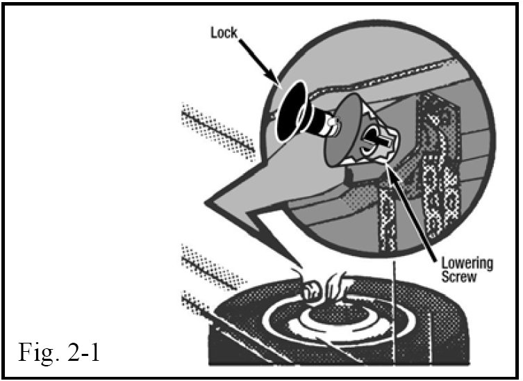

    dont have a spare tire wheel lock on it that requires the proper key?
    fire off a pic of your setup.

    Sure you don't have a lock installed? It is well-hidden when installed, and would prevent the hook from seating.

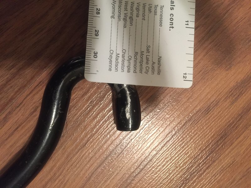

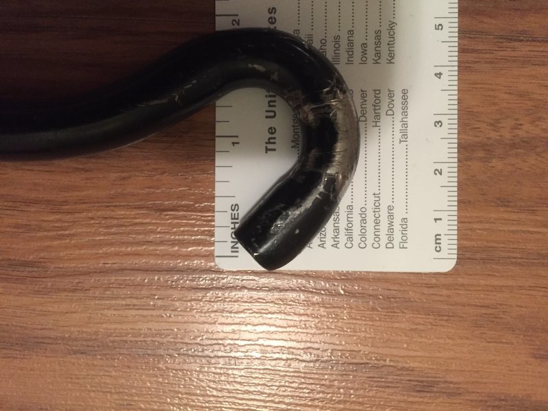

    Again, no lock installed. The diameter of the hook end of the lowering bar is too big and does not seat into the lowering screw.
    The picture below is what Im talking about.

    Any chance of seeing the hook?

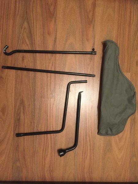

    Well I did some google and Ebay searches to compare what my tool kit looks like compared to online pics. And it looks like I dont have the right tool kit. Maybe swapped out by the previous owner or by the dealer when it was last sold used. I dont know anyone with a Tacoma here to compare so Ill hit up the dealer on Tuesday to see if I can verify if my tools are right or wrong.
    Here are pics of the tool kit in my truck.

    I think you have the 1st gen kit and hook.
    My 2nd gen hook does not have that bolt on the end, and the hook part is shaved down to be thinner.
