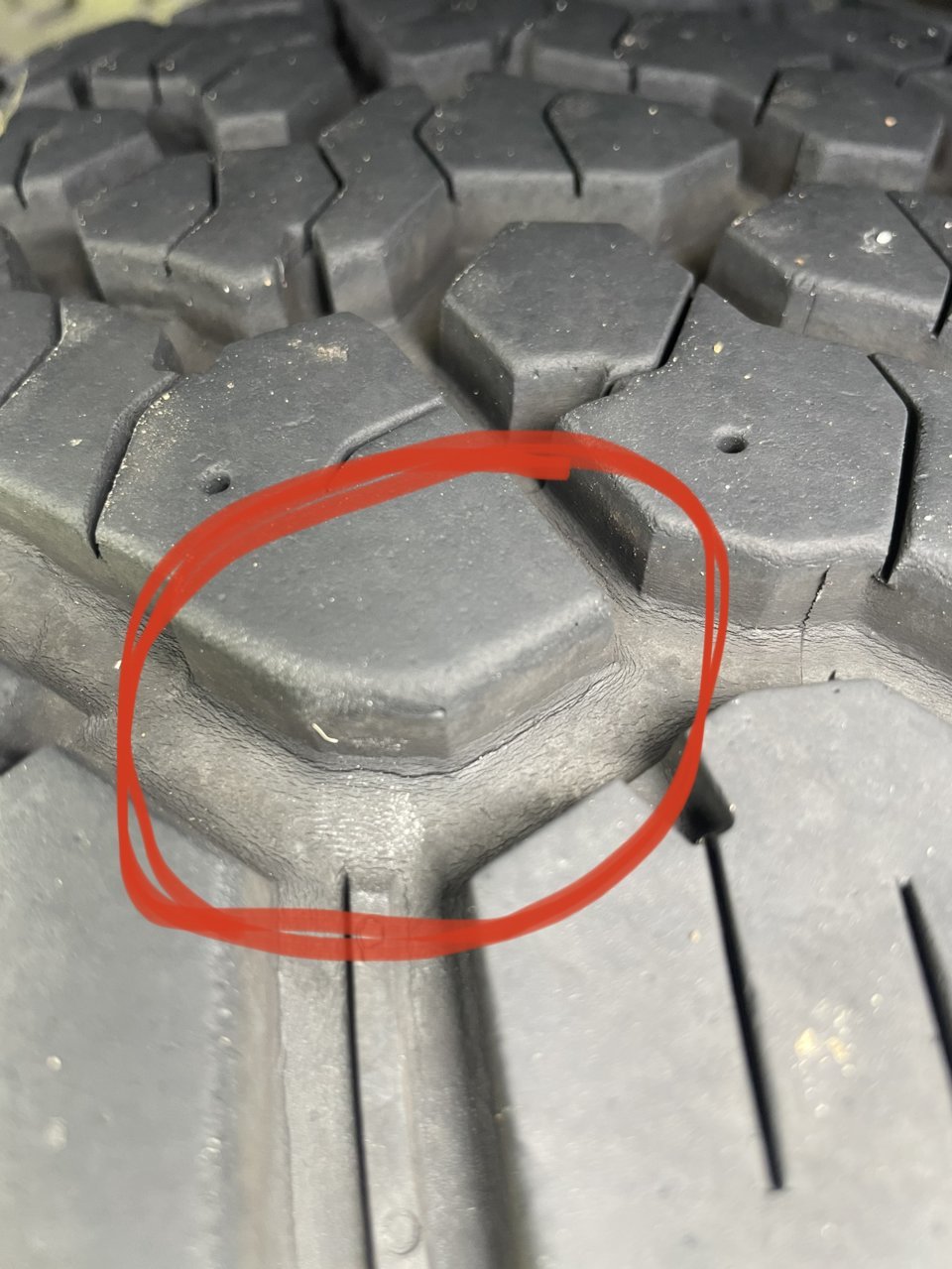

    Looking for advice/opinions…My General Grabber ATXs have approximately 35K miles on them. Recently I noticed what looks almost like dry rot around the edges of the tread blocks. It’s pretty widespread and on all 4 tires.
    Is this a problem or not a problem?
    When I push the lug with my fingers, I can see the void (circled in red) get a little bigger so it seems like the tread blocks are almost separating from the carcass of the tire. What does everyone think?

    I'd replace them, but I'm sure others will say they still have life in them.

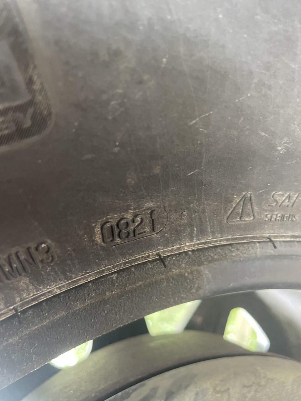

    What is the date code? How old are these tires?

    What's the tire manf date on the sidewall?

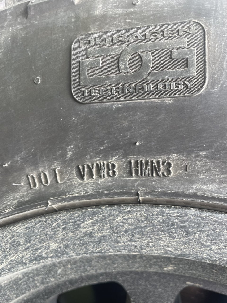

    I purchased them new about 2 years ago. I believe this is the date code, right?

    That's not the date code. It will be a four number code, first two numbers are the week from 1 to 52 of the year, last two are the year as 21 for 2021. first week would be 0121 date code. And it's only on one side of the tires.

    Okay thanks, standby…trying to find it.

    They are chunking out.
    I’ve driven on much worse.

    Okay found it, I had to crawl under the truck. Also found the purchase receipt, I bought them in August 2021.

    Only a couple of years old. Have been exposed to a lot of sun light? Still under warranty? Are the sidewalls showing signs of cracking or just the tread? I would be more concerned it the sidewalls are showing the same cracking.

    I would be concerned too. I would replace the tires as long as warranty is good. If cracks in the threads, I'd replace them ASAP before any one of them explode.
    I had a tire exploded when I was younger, the sidewalls were intact, stayed on the wheel and the middle part is gone....
