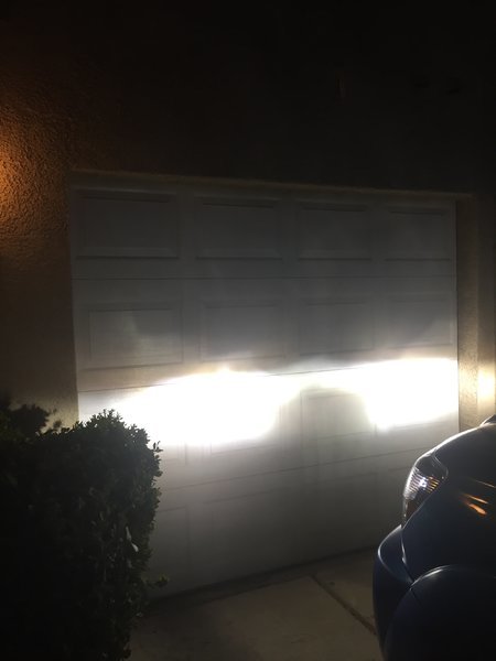

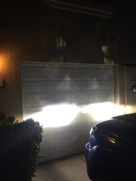

    Hey bud good post I just put my opt7 flux beam and I'm not happy with them. image.jpgThis is low beam.
    image.jpg This is high beam.
    Gonna try your mod and see how it work! Thanks for the post

    Yeah, that's what mine looked like before the mod. Hope it works just as well for you as it did me.
