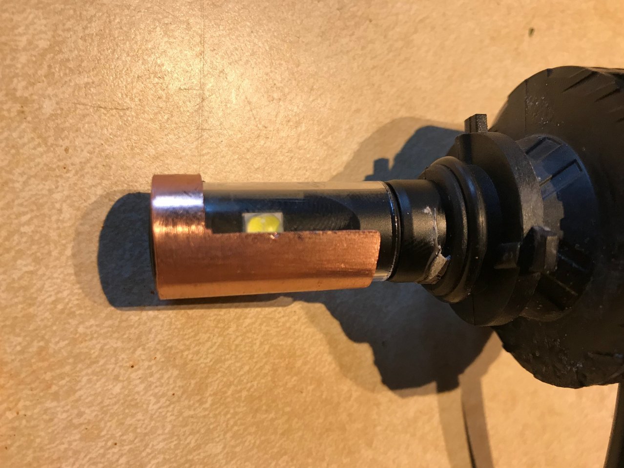

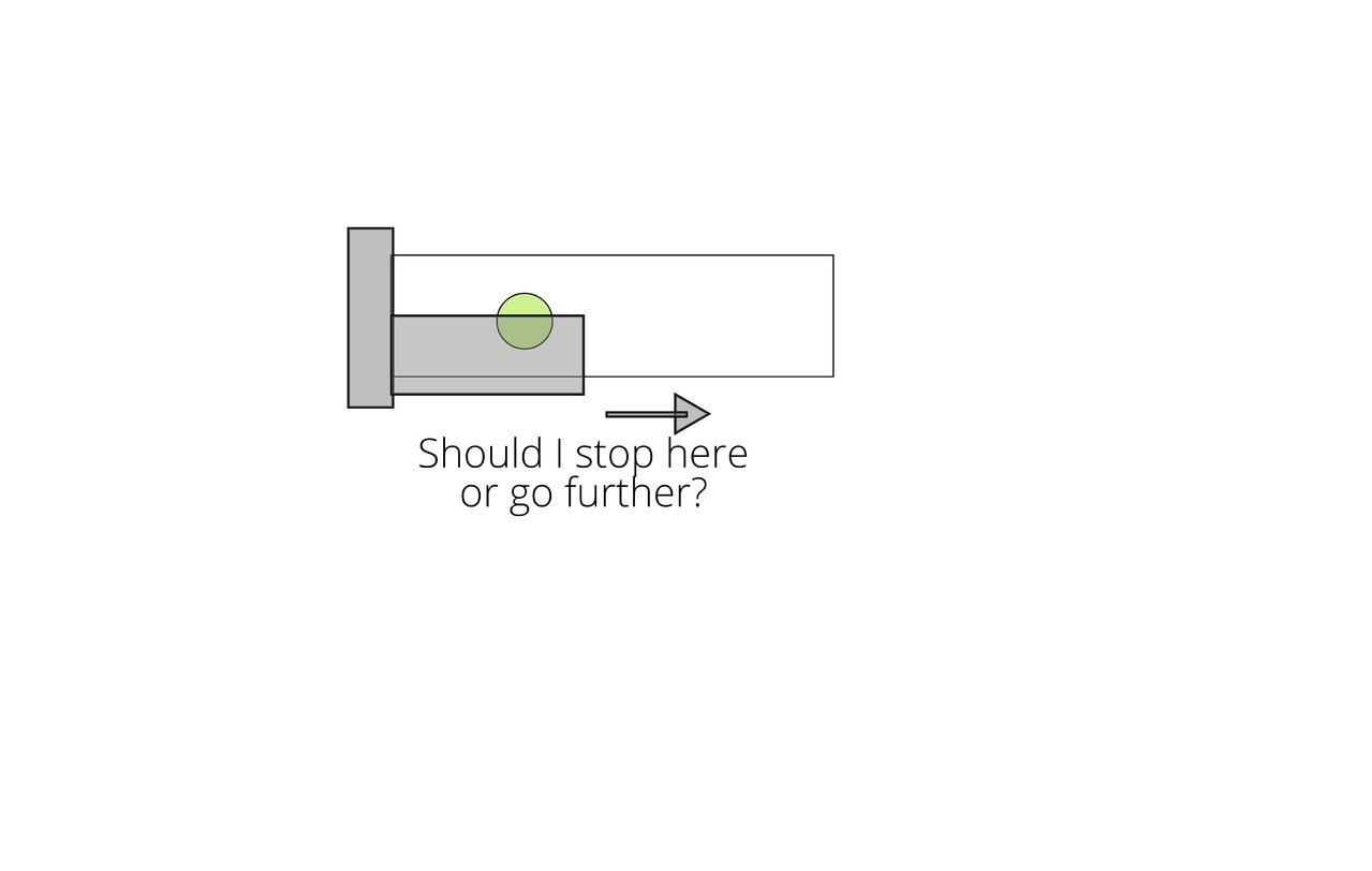

    Got the copper, should it go slightly past the led bulb
  9. Jan 25, 2018 at 1:35 PM
    #129
    gshockfreak
    gshockfreak Member
    Jan 24, 2018
    #242294
    5
    Alright so I did one short right to the end of the led and one long. Going to check them tonight, EXCITED!
    This is the long one
