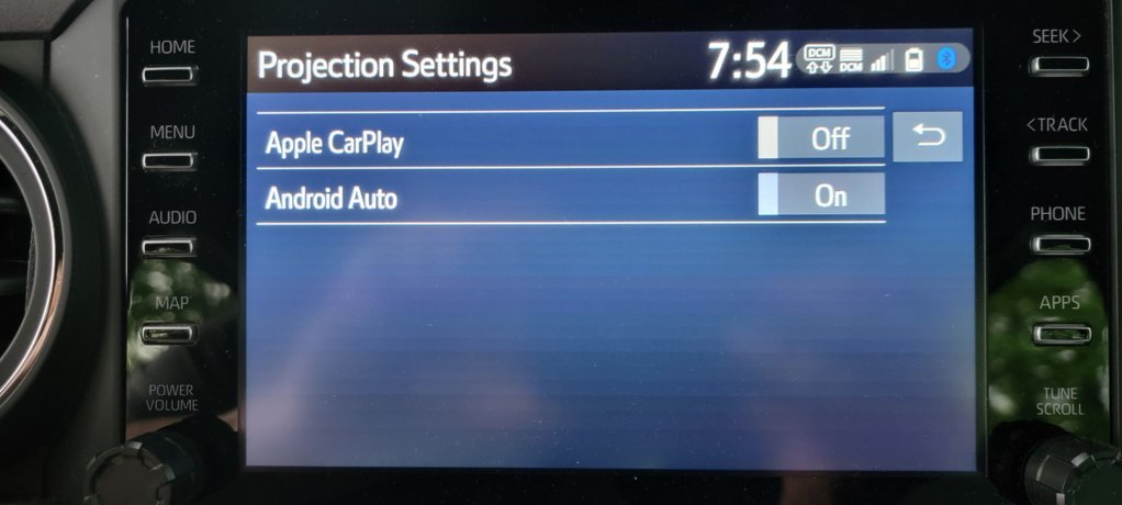

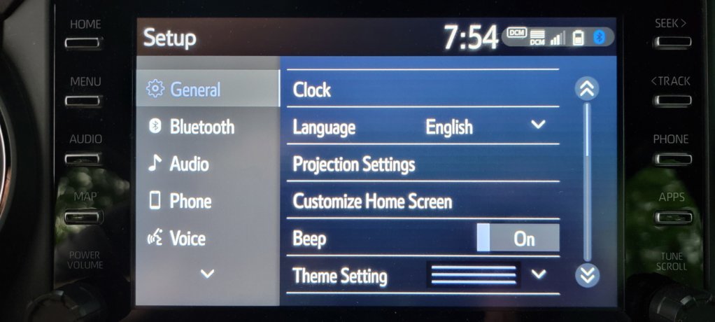

    Check that Android Auto is enabled in the Setup menu on the head unit: Setup>General>Projection Settings

    And keep in mind some of the Setup stuff is only available in accessorie mode. Not with the engine running.

    It's alive! Thank you all, much appreciated!:taco:
    I would never in a million years have looked inside "Projection Settings" and, I did it in accessory mode as suggested just in case.
