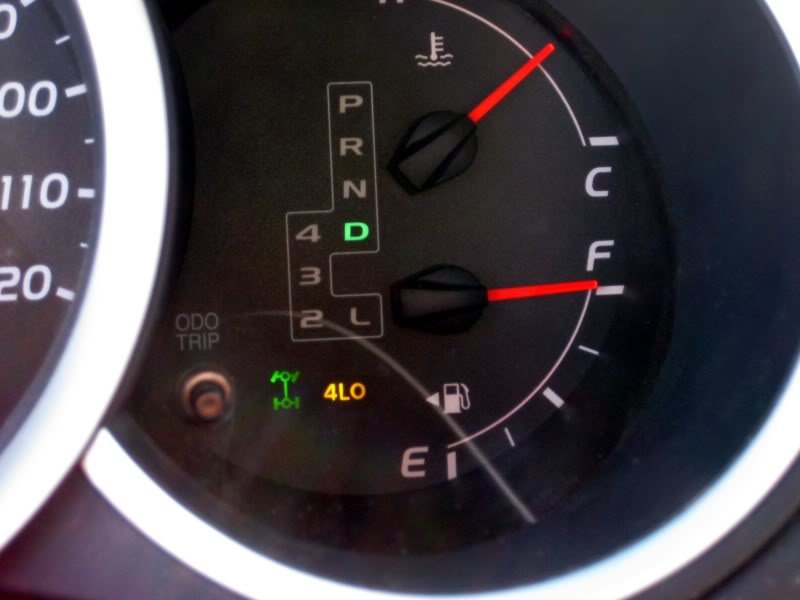

    Just want to let you know we finally got some snow and I tried your method, with the clutch all the way depressed in neutral. I think for the first time in 10 years of ownership, my truck has for the first time been engaged in 4LO, without the beeping. Thanks for your help and it seems to be working, even after all these years without being fully engaged.

    Wow... 10 years?!
    Note to everyone: Beeping is bad.
    There also is a 4 LO Light that comes on only in L4.
    These details are all in your owners manual... and then there is the card in your sun visor (note #5-1):

    My problem was that I wasn't fully depressing the clutch, so it never fully engaged without the beeping. I thought the beeping was a warning that you weren't in 4HI. It's so nice being in 4LO, without the constant beeping now....LOL (but kind of sad too it took so long) :oops:

    I'm happy that I didn't have a stuck actuator or problems with 4LO. The 4LO light was on before, but I think the clutch not being fully depressed caused the beeping and it did feel like I was in 4LO before, but with the beeping.
