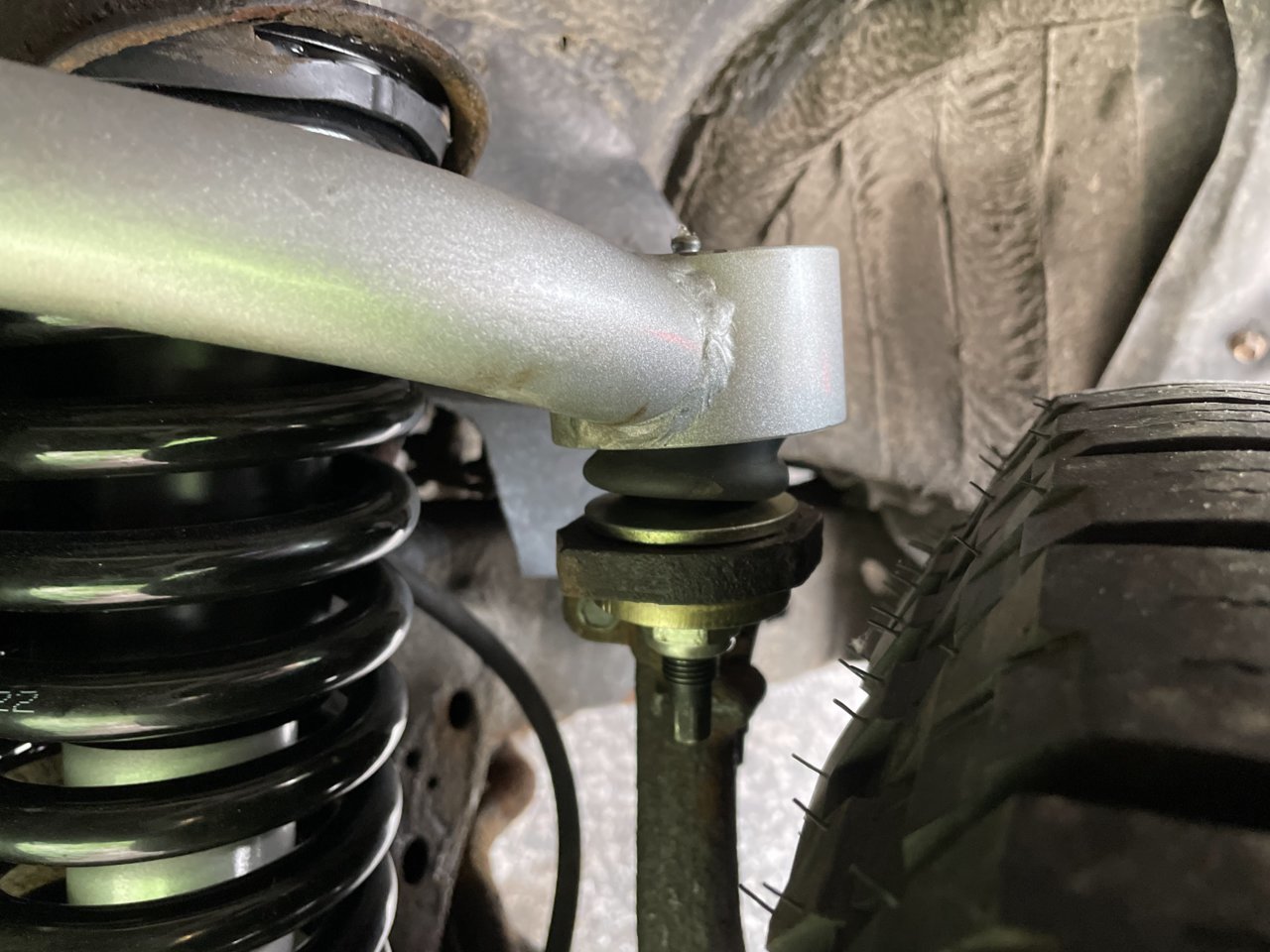

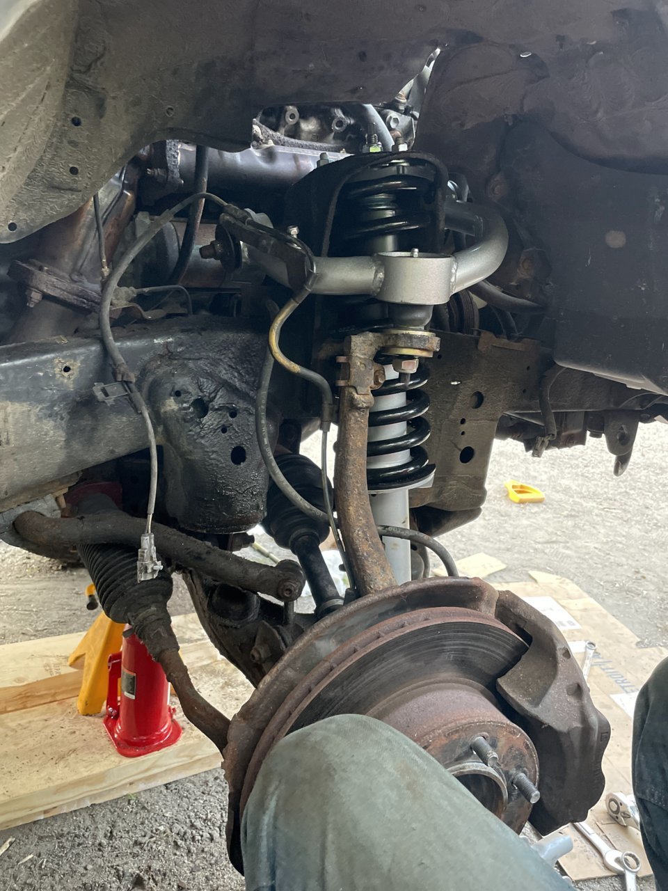

    I ordered these control arms with ball joints (https://www.ebay.com/itm/143583269260#vi-desc-maincntr) and installed them last week but can't get the ball joints to sit in the spindle correctly. The washers seem to sit right yet there is a ton of play no matter how tight they're sandwiched on there. I know they're ebay parts and probably unreliable, but has anyone bought these and/or have a solution?

    Compare the profile of the new ball joint stud to your old stock one, see if anything stands out.

    Either your arms are upside down or your ball joints are installed upside down.
    If they are compared with the stock upper ball joints.
    this is a 4x4 ?

    Did they come with decent instructions? Was there a knuckle adapter you needed press in?..?
    All parts that are assembled by you are in the correct order?

    There’s no top washer on my aftermarket UCAs. I’m wondering if that top washer wants to be below, either on top of or below the one that’s there now. If there’s no metal surface for the top one to push on then it isn’t doing anything. It’s possible both washers belong on the bottom.

    This^ with SPC control arms theres an adapter for the ball joint

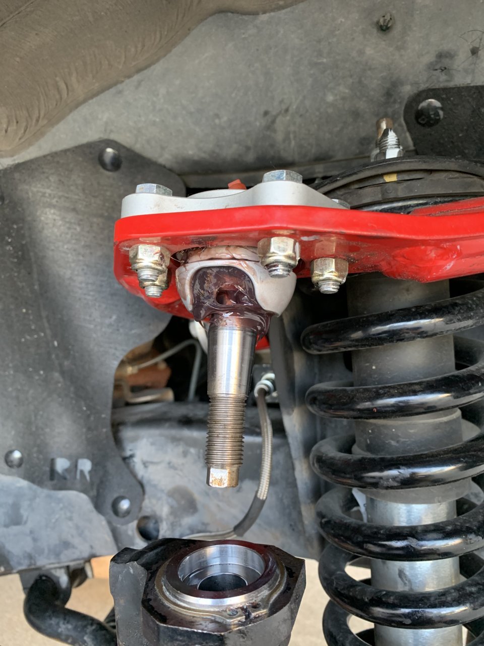

    I think the top washer is preventing the shank of the ball joint from fully seating. Gonna attach a pic of when I was changing out boots on my JBA uppers. Again, no top washer. The ball joint shank is fluted and passes all the way through the adapter getting the washer(s) on the bottom side only. Could be this simple if OP winged it without instructions.
    OP did you get a knuckle adapter in the kit or two flat washers?

    I don’t entirely understand how your setup works

    See the c clip on his knuckle? It's a custom fit adapter for the joint to sit into.

    I think hes saying you need an insert to go into the hole in the spindle.
