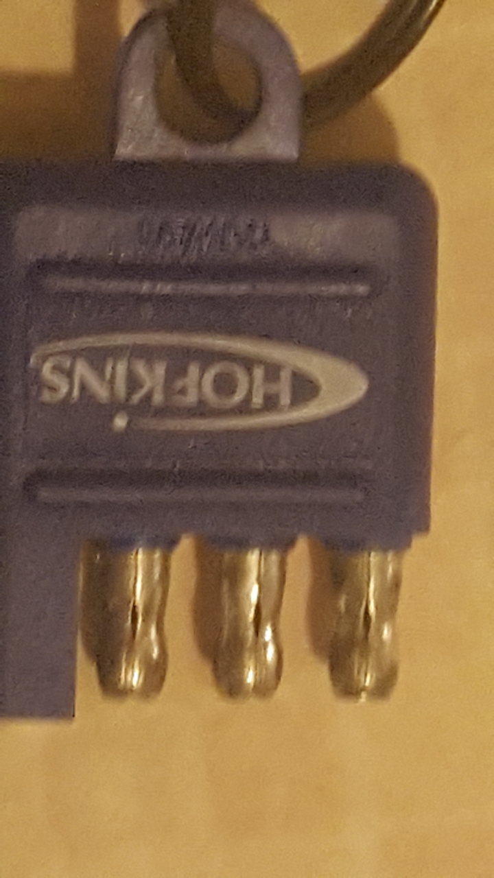

    It’s the T-1 connector.In 2014 the camper place installed the brake controller and wiring for camper on my truck . They did not use the actual Reese harness for a Tacoma but anyway it’s been tested and the ground is bad in it . Was kind of half assed under the bumper kind of out in the elements . So ordered this :916A52CC-DF59-4730-BB08-27CB2A0BA911.jpg
