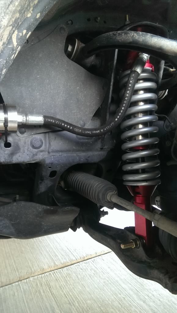

    I'm going to take the tires off right now and I'll post pics, then see what you guys think, both sides Make the knocking noise, only when I go over bumps though

    This is jacked up
    Tire off
    Still a lot of threads left
    This is how far it can move if i try and twist it

    Im at 22 3/4 in. from hub to fender so its sitting lower then it was with my spacer lift i had before

    I looks normal but I definitely dont like the look of the gap on the lcm. If i were you i would buy some generic bushings to fit around the bolt to eliminate some gap.

    ok ill do that, but theres nothing rubbing or metal on metal, but when i hit a bump on whatever side i hear a knock, but also does anyone know the measurements for lifts? what stock is and how high i can go, because there is a ton of threads left on the shock

    Looking at pictures, you don't have the bottom bushing in correctly. Or you have the wrong one. Also, your top bolts don't look like they are protruding far enough into your coilovers from the top. You might need to find some longer bolts for it.
    I'm not sure about the rest..

    Something looks wrong with the way the Strut is mounted to the lower control arm. Call Camburg Tech line tomorrow and see if you can email them the pics and tell them your story. Again strut mounted to lower control arm looks wrong.

    Those are from poly performance, but could that be the cause of the knock?

    They had me call poly performance for those spacers because the ones I got when I bought the coils were too small for the stock bolt

    Damn, what a mess man. Check all fasteners to ensure they are tight. That's where I would start. Next check your spherical bearings and make sure they don't have any excessive play in them other then their obvious rotational movement. Next I would take a good look at that spring. Something don't sound right there. What size is that spring? How does it feel driving? I almost think that you need a taller spring based upon how that looks, it would further allow for less preload on the coil over to lift you, which as an end result would cause less harshness on bumps. Clicking over bumps ain't right. Not even for the SAW remote reservoir coilovers.

    The coils ride great, my buddy rode in my truck yesterday and was impressed, but I told him about the knock and he heard it too. The spring has 13/650/A/3 on it so Im guessing it's rated at 650 pounds

    OP, I think I know your issue. Have you checked your UCA to Spindle nut on the ball joint? It doesn't look like it is NEARLY tight enough. Remember, torques should be done after weight is on the wheels.

    One more thing. Ideally those misalignment spacers on the bottom should center the lower rod on the lower control arm. I don't know if you could see it in this picture. I hope you can.
