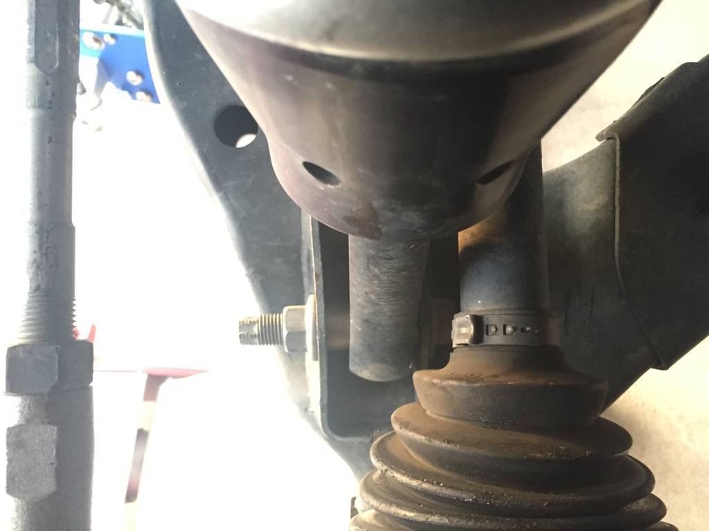

    Yes they will if they are contacting the mount.
    My suggestion. Get new misalignments. They should be 1.5". Measure the distance between your LCA shock tabs just to be sure. Mine transferred right over as they were the same distance between stock LCA's and Dirt King lowers so your should be the same.

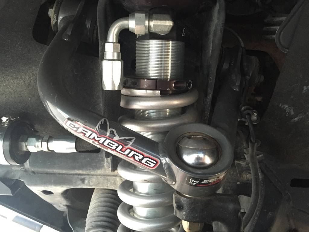

    True. I'm not sure how his coil over being attached to the LCA the way it is would make that noise. Mine are the same way and I have no problems. As far as the picture with the uca bolt to the spindle, it looks loose so that may be causing the noise.

    Remember. The ball joint nut should not be pressed on there so tightly, because if it is what can happen is it can apply so much pressure to the point where the joint can pop out so as long as it is tight, and has the cotter pin running through he is fine, because the nut will not back out.
    Remember, you have Icon's. These are Sway- Away's. Identical in design, but regardless, should not touch the mounts.

    When I turn it jacked up or on the ground it just moves that 1/8th of an inch in the LCA mount that's it, it feels solid and in there, the spring doesn't move, just everything as a whole moves on the spherical bearing until it stops on the LCA mount

    so the misalignment spacers should solve that problem?

    All of you guys are hitting the LCA mounts in general. You and Tyndall. That's a problem you guys should address anyways. As for that sound. Can you get a GoPro in there? It's really hard to address it when I can't tell what is going on in there other then compressing and rebounding.
