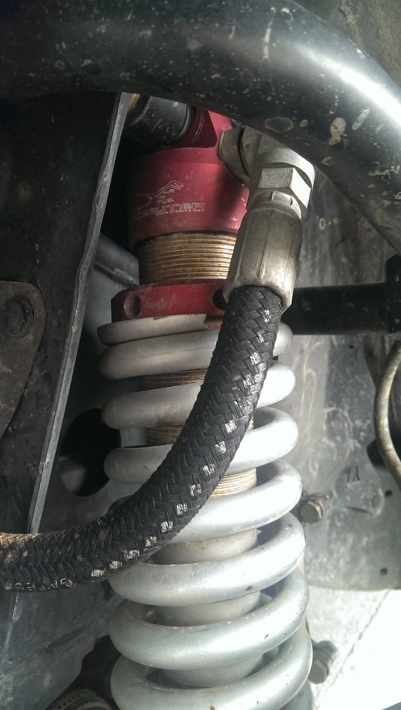

    I think it is the springs. What springs do you recommend? I i can figure out how to mount a go pro in there ill try to take it for a spin just to confirm. I will have to get the correct backspacing as well.

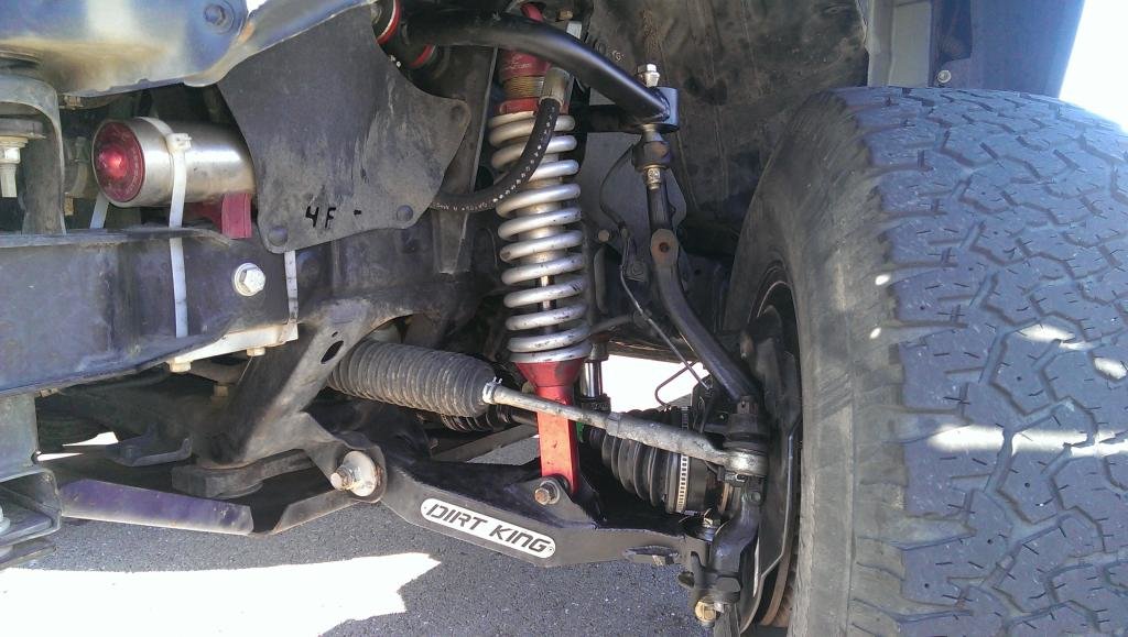

    but if i compress the spring so much how could it jump around? its sitting at 22 1/2 inches right now so thats a 2" lift, there are a really good amount of threads showing

    14" 650# spring on my setup. Look how much threading is exposed. Only 1.25"

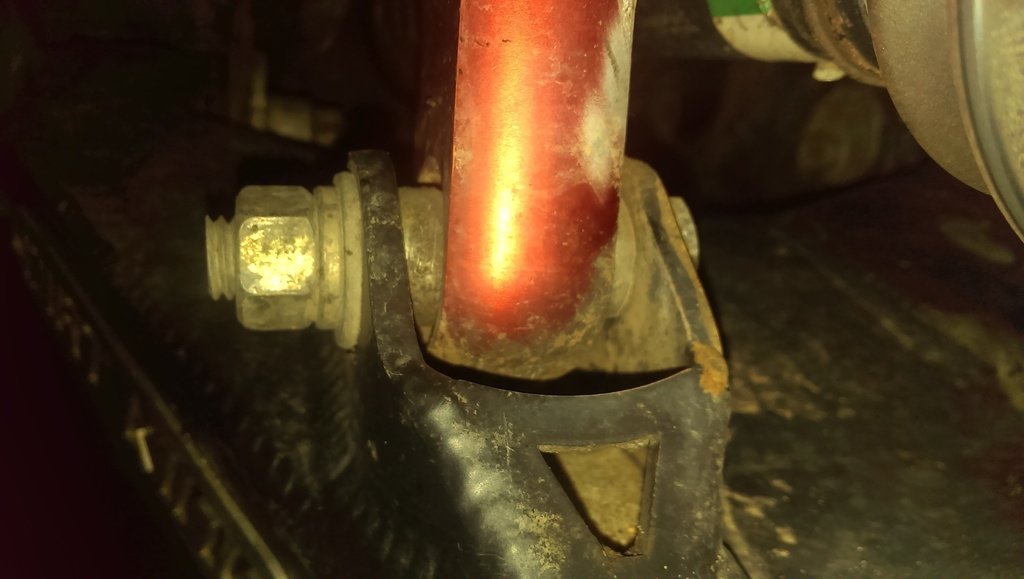

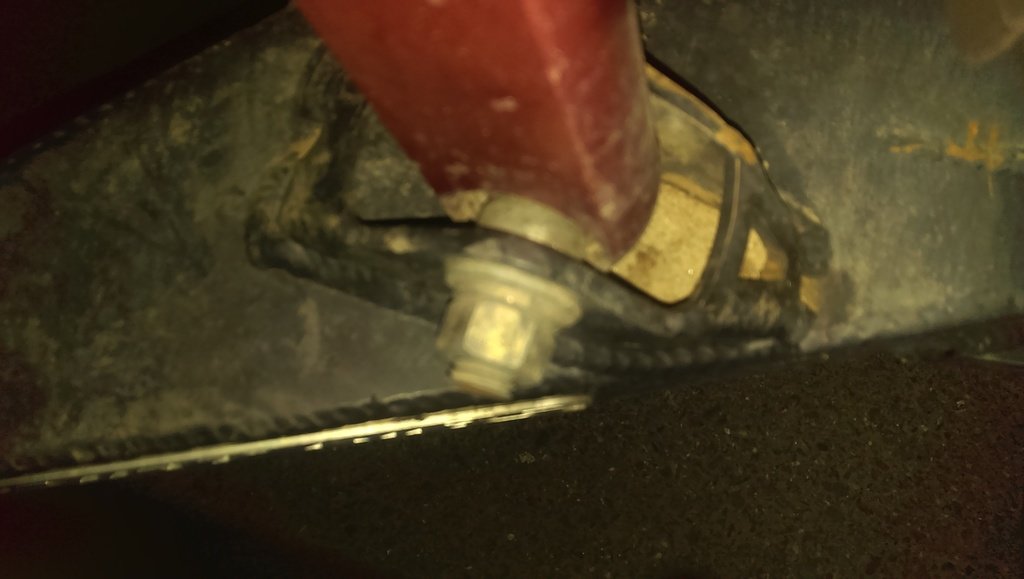

    Can you post a picture of your lower mount in the LCA?

    Let me take a picture of my lower mount shock spacers.

    Just went wheeling. Sorry it doesn't look beautiful.

    Yep. Gotta be your spring then. I need measurement on how compressed that spring is at droop out still.

    The spring measurement with the wheel off the ground. Top to bottom, from where the coil is flat up top, to where it's flat on bottom. Take a tape measure and measure it out.
