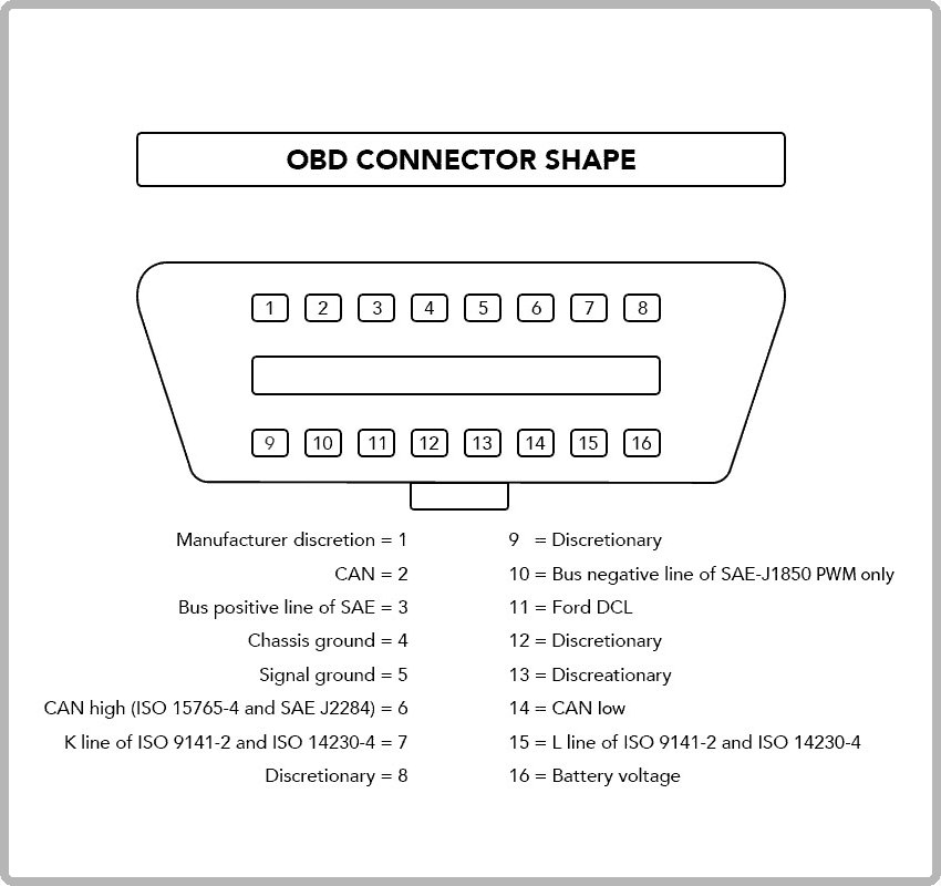

    First check that there are no piggyback devices on the OBD port then check pin 16 for power and pins 4 & 5 for ground, also may sure no pins are out of place.
    If that all checks out your gona need someone with an oscilloscope and knowledge on how to diagnose the CAN bus system.
    I'm assuming your referring to the 2019 TRD in your profile? Do you still have warranty on it?
