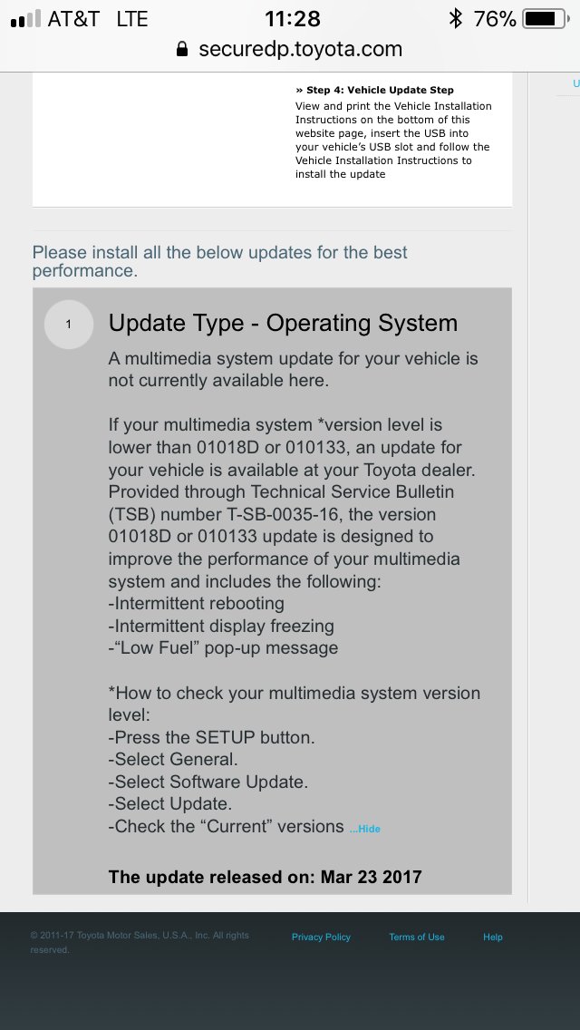

    No, you can do it on your own, all you need is a flash drive and download the update and instruction, slap it into the slot by the power outlet in the dash and go.

    I get this message when I put in my info.
