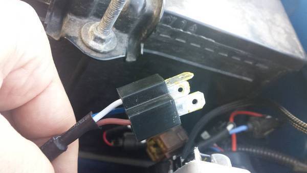

    having same issue. Are these brown/red and white wires at the end of the 3 prong harness that plugs into factory slot? Only brown and white wires I see in this harness.

    This one?

    yep that's it switch the brown and white wire.
