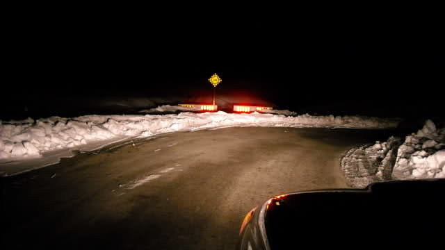

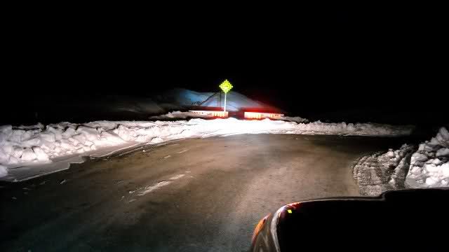

    They are aimed straight ahead, but with this amount of light you could aim one straight and 1 off to the side, you'll be sure to see all of those moose we have problems with ;)
    Here's the lights..
