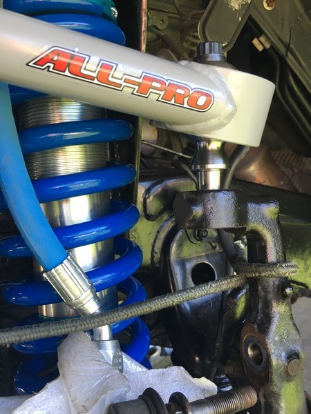

    Your upper control arm is NOT down all the way, if it was down all the way the uniball cup would be smacking into the spring. Losen you UCA bolt a bit and just pull the UCA down.

    You might not be able to see from that pic but the UCA was down far enough to hit the spring. With the LCA jacked up there was still too far of a gap to connect the spindle.
    I measured the shock it is 24" from end to end.

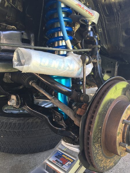

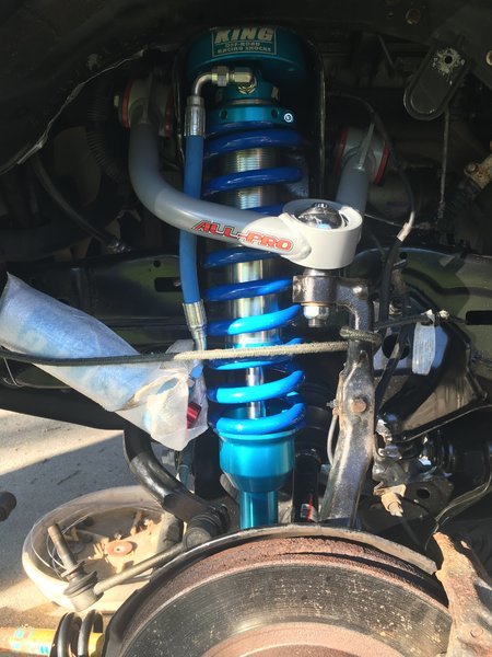

    The UCA is very loose. The first pic I posted showing my hand is to show about where it should be. The second set of pics without my hand shows the loose UCA in down position and the LCA jacked up where it actualy started lifting that side of truck.

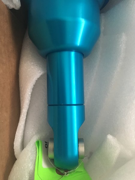

    I think this is my problem. Looks like there is a 2" spacer in the bottom shock

    You should be able to download a diagram of the shock. And that would tell you.

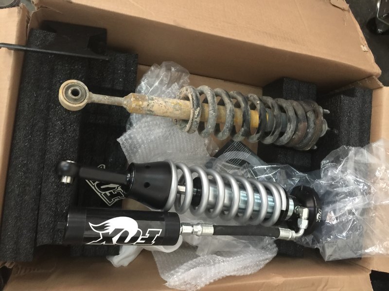

    Here is a pick of my ext travel fox near stock. These fit fine.

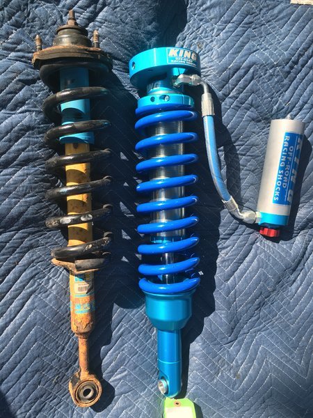

    If they are off the truck let's see them lined up next to the stock ones

    Anyway. Side by side they do not seem that much difference in length. Gonna give it another shot

    You may need to unbolt the two bolts that attach the LCA to the spindle. lift the spindle up to seat the upper arm bolt and torque it. then let it use the weight of the hub/spindle/rotor to droop enough and meet in the middle with a jack under the LCA to put the two bolts back into the spindle. Also loosen the LCA bolts at the alignment cams, may be stopping it from going up taller. Youll need an alignment regardless.

    Id say remove you're sway bar link , you're steering linkage , and spindal from the UCA. Once new shock in just thread on the top 3 bolts and then try to align the bottom mount on the LCA. Then I'd use a jack to apply pressure to get the UCA bolted to the spindal again

    That is how they are supposed to be.

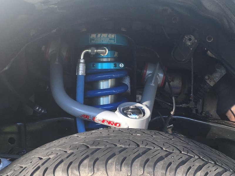

    Okay. Looks like I owe a round of beers!
    I believe I started out doing everything correct but when I saw the truck lifting from jacking I stopped and thought there was a problem. I took everyone's advice and I am greatfull

    Without wheel on
