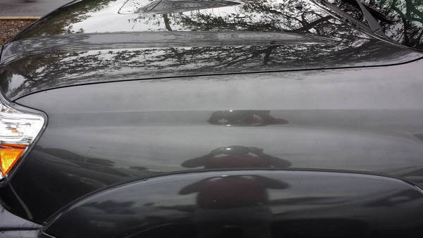

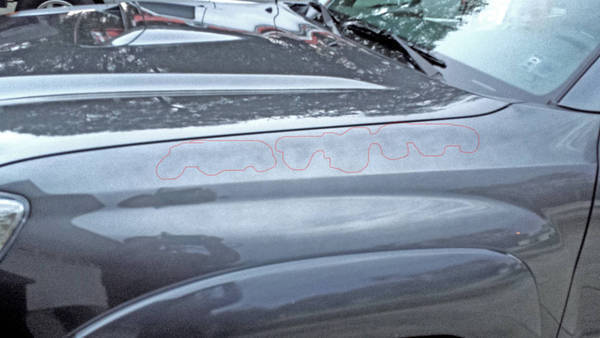

    Purchased a 2014 Tacoma three days ago. Got a good look at it in the daylight two days ago and noticed some blotching/uneven marks in the base coat on the front left quarter panel. I was curious if anyone else has experienced this or has heard of others experiencing this. The problem is not as subtle in person as the pictures may suggest.
    I have contacted the dealership and await the manager's call back tomorrow. This is killing me. Right front quarter panel is fine, as is the rest of the truck. I cannot believe that this is just the nature of dark, metallic paint.

    looks like it will buff right out. looks like rust marks from being transported by rail car.

    This might be a hassle to argue with the dealership about. Once you drive it off the lot they don't cover cosmetics. If they are a reputable dealership they will own up to it, obviously you didn't do this yourself. And yes, it looks like it was from shipping.
    Did the dealership have time to inspect it and what not? Or did you pick it up right after it arrived?

    It looks like it's under the clear-coat, not cool. Make sure they confirm the truck has never had body work. I worked at a dealer for many years. Lot damage is very common. They could have bumped the truck, and fixed. Not saying they sold it without telling you but you never know.

    Prolly an issue with whoever/whatever sprayed on the paint at the factory (assuming it wasn't resprayed between there and your dealership)... anyway they/it didn't lay on the metallic evenly resulting in that type of inconsistency. That's pretty piss poor in terms of quality control, best of luck. I can relate though. Even my truck, BRAND NEW, came with several long scratches on the roof that I didn't notice until after my purchase. I was able to lighten them up with some buffing, but still it bothers me. Add to that I'm only at 1200 miles and already have a noticeable rock chip dead center on my windshield. Can't keep anything nice any more.

    Call your salesman today and tell him you have rail dust on the fender and schedule an appointment. You'll want to get that off as soon as possible so it doesn't etch the paint. The dealer will know what this is and they have a special product to take that off.

    Def. looks like the metalic us unevenly dist. on the panel. I had a tundra like that in 05. it looked almost like tiger stripes in the sun. lol

    kinda curious how you guys think that is rail dust, doesn't rail dust look like lil specs of rust, that will come right out with claybar or compound?

    Looks like that panel got repainted... was the truck damaged on the lot? :confused:

    First of all, metallic paint is SUPER hard to spray properly... It can & will do some pretty funky stuff if sprayed incorrectly (tigerstipping, mottling, etc).
    Second, "rail-dust" is pretty hard to get UNDERNEATH the white protective plastic sheets they stick to most of the vehicles painted surfaces...
    Which happen to cover the fenders (and hood, and roof).

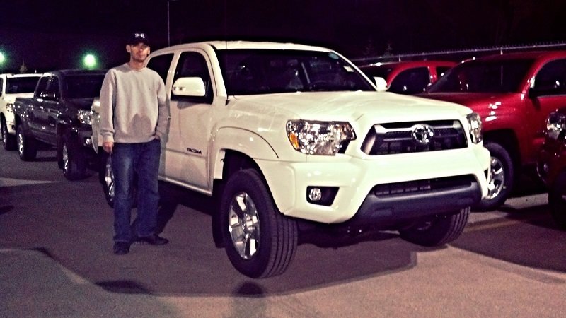

    You can sorta see it on my truck here, the night it arrived @ the dealer... Fresh off the train.

    x2 on the rail dust theory. Shouldn't you be able to feel it after a good wash? If the surface is smooth, I suspect poor painting of the base coat.
