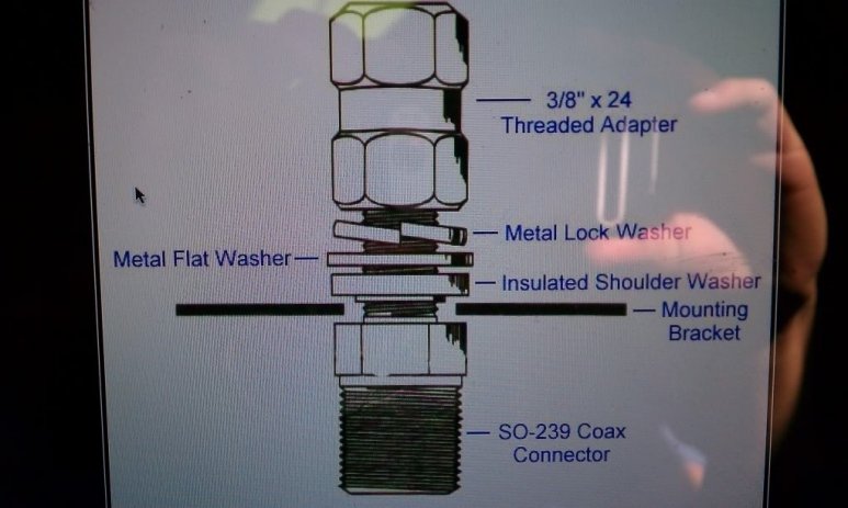

    Do you have your antenna installed right alsoc6e4d2c5-a256-f141_998705b1f14feb90eb961a8fa7efee1ce32887c5.jpg

    Make sure that the antenna mount is grounded properly and that the antenna is NOT grounded! As mentioned above, proper tuning with a swr meter is essential! Also have at least 2/3 the antenna above the roof. Do not loop extra coax, it there is extra coil it in a figure eight.

    the antenna doesnt need a ground, it mounts on the roof of the truck so the antenna is very high, also the coaxial has no loops, sweet thanks jaun! me and jordan both need it

    I didn't know it was a magnet mount. And the mount still needs ground, but it grounds itself through the magnet being on the roof.
