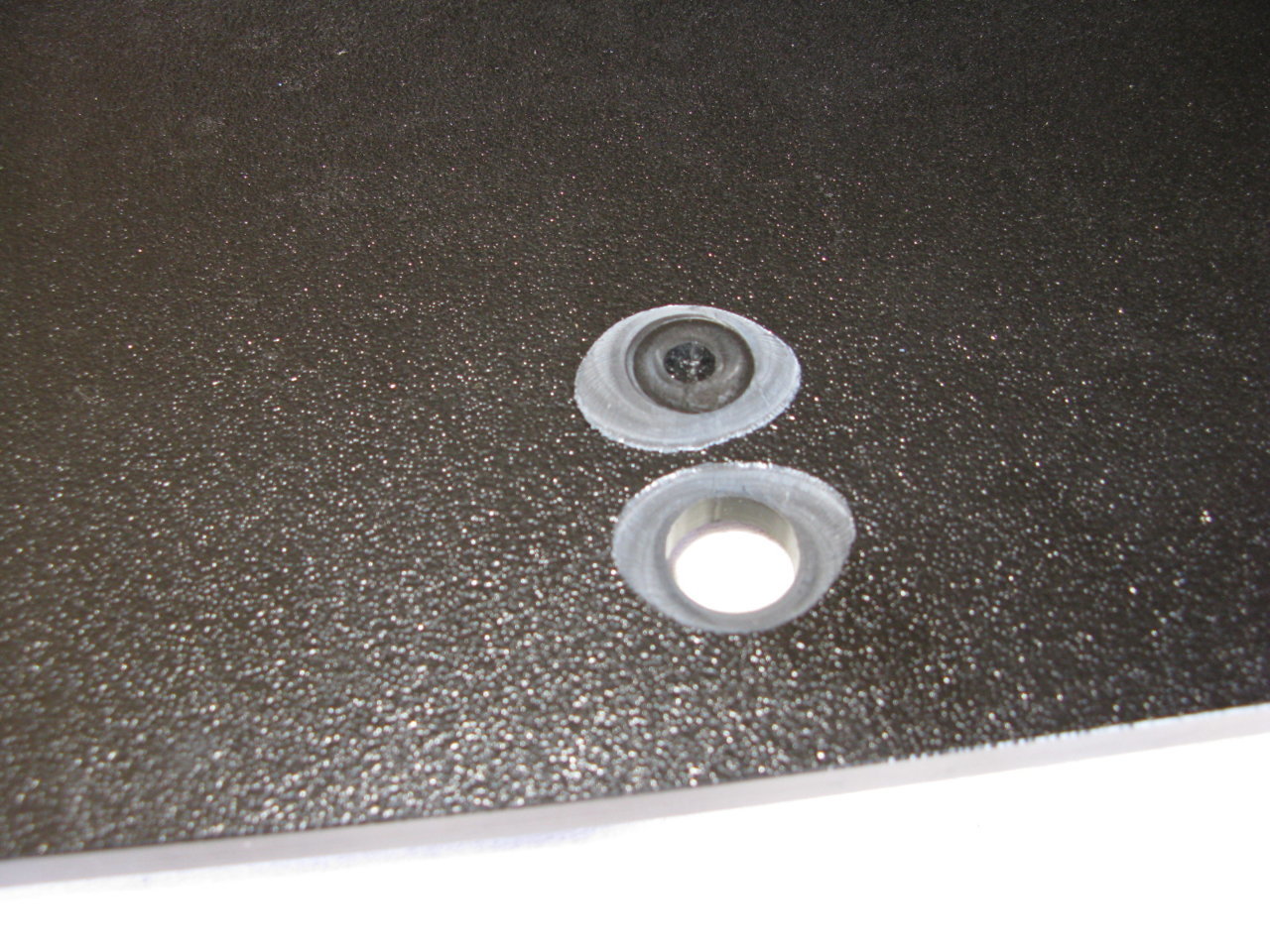

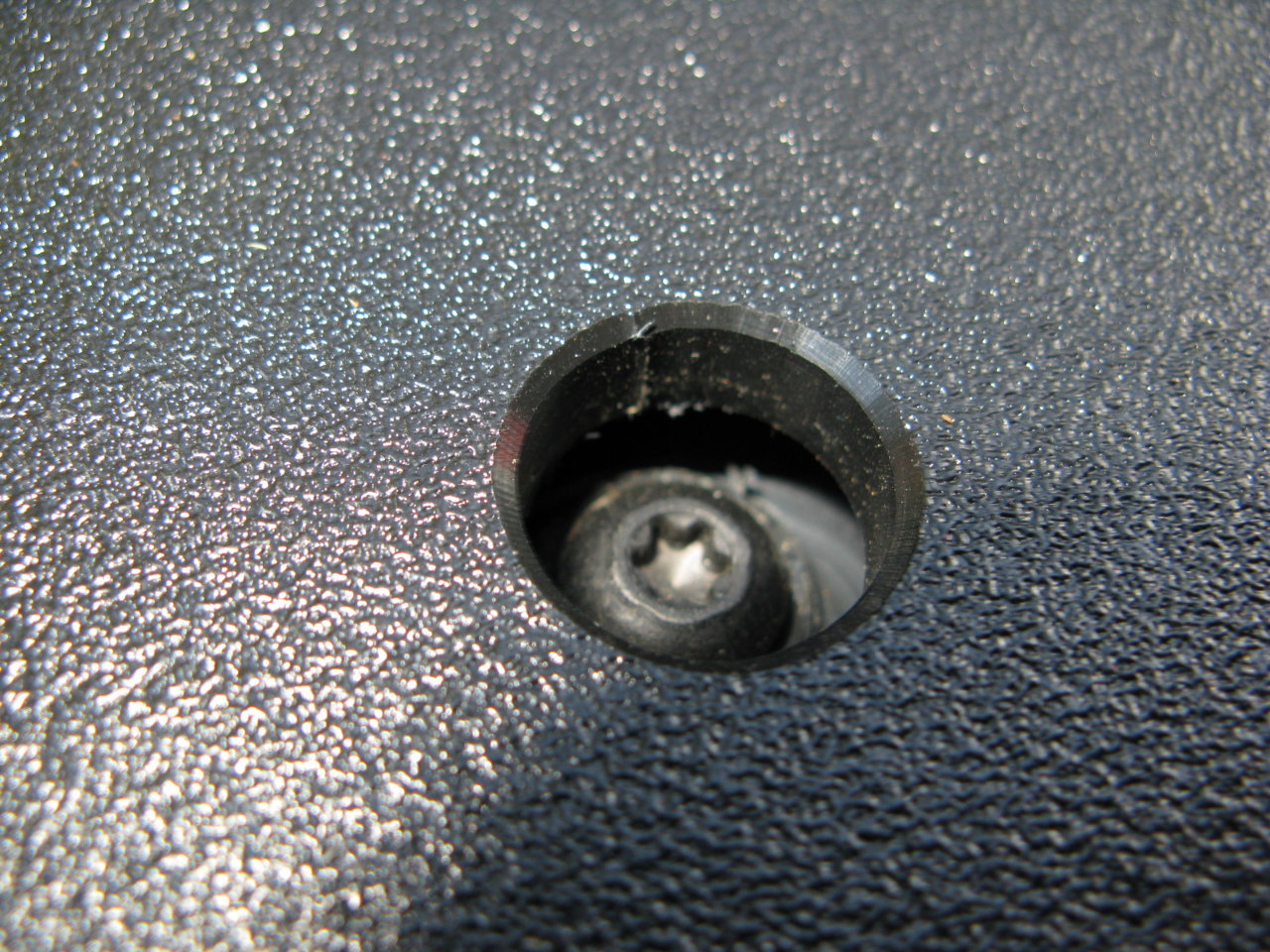

    I bought one of their tailgate panels back in April. Kinda spendy but I liked their idea.
    After the Labor Day holiday, I was unloading some stuff and I noticed that the bottom
    recessed screws had pulled through the delrin panel.
    I notified Mountain Hatch and after a few e-mails they said that they had were aware
    of similar failures by some other customers.
    I was told last week that a replacement had been sent to me on Tuesday the 10th.
    Well, here it is the 18th and no replacement.
    So much for customer service. Looks like this is one of those times when Made in the USA means nothing except you get to pay more. Too bad.
    I'm going to try to salvage it somehow. It cost me too much to just trash it.

    Just get a washer and fix it yourself for $2 at the hardware store.

    That's what I was thinking.

    Counterbore looks too deep. They ought to change it to a countersink and include pan-head stainless hardware. Just my 2 cents.
