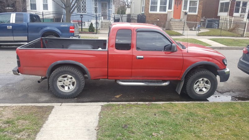

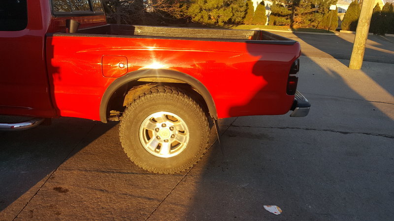

    Anyone tell me if this is normal. To me it looks like its moved back. I live in Detroit so there is a bunch of pot holes would that do it? Or could it be something else? I can't remember if its been this far back the whole time I've had this truck. Just walked out to my truck one day and just thought it didnt look right. 20170307_175834.jpg20170307_155246.jpg 20170307_175826.jpg

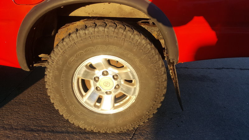

    Nevermind just found out the problem...both sides are like that 14889920981751397578814.jpg

    Is this fixable or should I go with a frame swap? It also has some rust cracks about 18" long or more on the bottom of the frame.

    Damn that's bad. You need to frame swap or get real serious and pretty much build a new frame. I'm surprised it didn't fall apart when driving.

    From the picture it looks like the hanger is completely rusted away from the frame and is now wedged into the frame by the pressure of the leaf springs...
