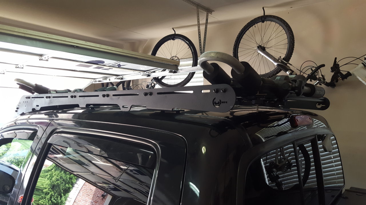

    I wanna see a pic of an '05 Taco with a cargo light.

    It's the light above the rear window.. OP, get a gauge and check your fuel pressure and does pumping your brake pedal or lifting it up turns the tail lights off?

    Red lens, only comes on when you press on the brakes? That's a brake lamp, not a cargo lamp.

    I don’t have a cargo light :(
    Were they on the earlier trucks but not the 12-15s?
