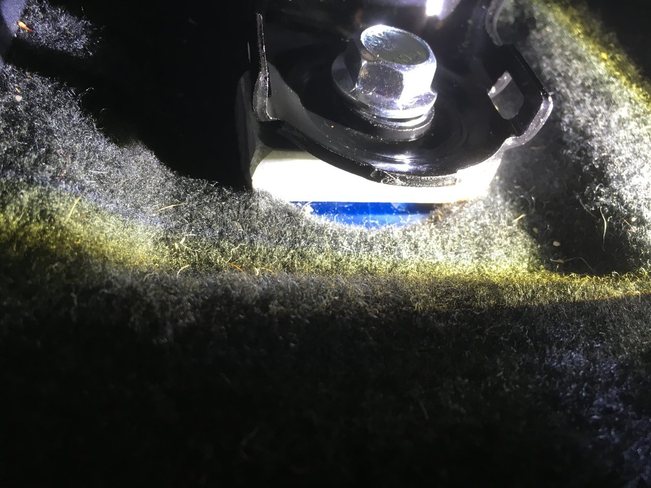

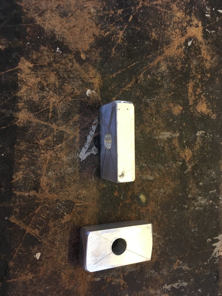

    I made these 1/2 inch spacers. I like the angle of the seat because of my old back. I figure if the x to the y and etc fail...I am getting up there in age any how.

    Is the 8 mm reduced diameter locating dowel necessary for anything other than not cross threading the bolt?

    Yeah, this isn't right. Just because you have the same thread engagement length and a 25% stronger bolt material doesn't mean you are covered from a strength standpoint. The failure mode changes with this mod due to fastener bending; the resulting tensile stress increase due to a 1" + spacer is considerably more than 25% for a #10 or 1/4" fastener. Now, we don't know the design loads and how close this fastener is to failing in a 'nominal' configuration. But I will tell you this mod changes the failure mode of the joint and results in reduced capability.

    the geometry won't work properly due to the angles being different on front and rear bolts,as you go up the bolts get farther away from threaded holes in floor,if that makes any sense
