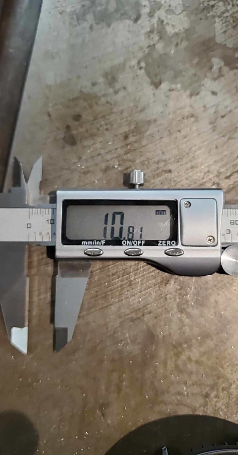

    Just measured the new style TRD Rims that came with my 2022 4Runner TRD PRO.
    I didn't had the drive to measure all 4 so I just picked up the top one.
    It came at 10.81mm depth.
    So if the drum is 11mm, we're talking a hair, or .19mm.
    Negligible in my opinion, as these are alloy rims, on trucks, not F1 or supercars.
    They'll get seated once the drum rings get a good rub with scotchbrite and the wheels torqued to specs.
    However, not a bad idea to machine them another 2mm to allow for a bit of rust in case one gas to change a wheel or fix a flat on the side of the road with basic tools.
    Just my .02
    Edit: As I mentioned, ive only measured the depth of the center bore on the top wheel, and these are brand new take offs with 20 miles or so on them, took them off the day I picked up my 4Runner and replaced them with one of the 2 different sets of wheels I had in my garage and never installed them, they've been sitting stacked on a piano dolly since St Patrick's Day 2022 when I got Patricia home from the dealership.
    There's no gunk, grime or any oxidation on the back of the wheel, and I never cleaned the back of it with a wire brush or scotchbrite.
    Never even washed them as they've never been dirty.
    Even with a 3% error at measuring, we're still talking half a mm difference, in my opinion not at all the end of the world once torqued to specs, they'll get seated without any risk of warping them.

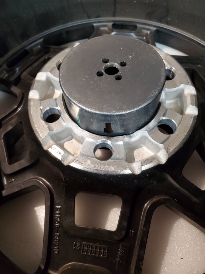

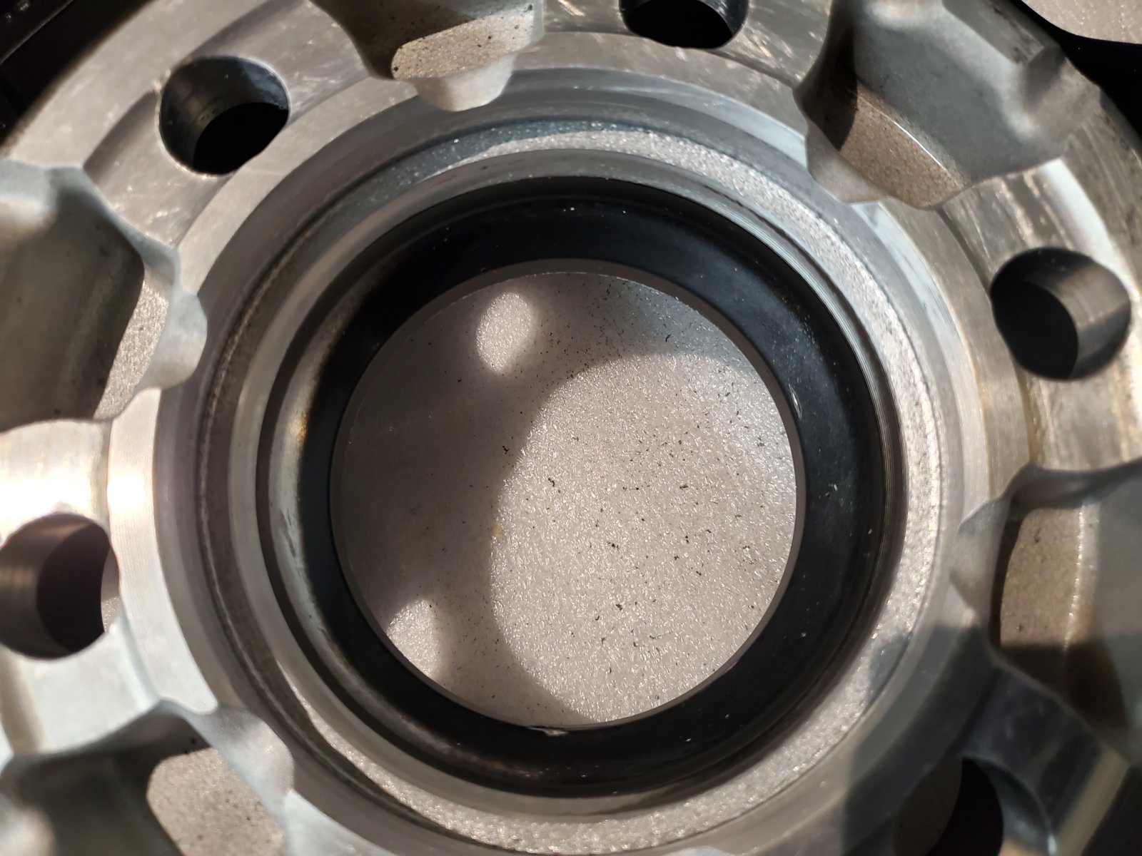

    UPDATE.
    So yesterday I went to the tire shop and had the tires taken off the rims.
    Went to a buddy of mine who's lathe couldn't be used for the rims, then to a rim store that quoted me $120/rim to bore them another 2mm. Asked around a few heavy duty diesel mechanics, no dice.
    So today I got anxious waiting for people to get back to me, so I decided to work on them in my garage.
    I used a 4-1/8" Greenlee hole saw, by hand(didn’t used the power drill) and rotate it in reverse.
    Took me the entire day, and, they turned MINT.
    13.25mm deep, no ridges, first 9-10mm on each rim are completely unscuffed so it shouldn't affect the structural integrity.
    My hands hurt like hell, but, I do NOT recommend using an electric or cordless drill with the hole saw as it will definitely skip (ask me how I know, cut my thumb pretty bad this summer drilling into plastic, the teeth are just too big fir anything other than wood).
    I don't like taking pictures, and the lighting isn't great for pictures in my garage, but, here you go.
    Too cold to pull the wheels off my Tacoma, but, I'll use a bit of antiseize at install.
    I put that sh!t on everything.
    PS: Bottom picture is the first rim I did, got a couple small dings when I tried rotating the hole saw clockwise, it's how I learned to keep going in reverse(counterclockwise). I also used a light coat of PB Blaster Multi Purpose Lubricant as I prefer it to WD40.
    PS2: I probably didn't need to go as deep as I did, and, if it was warm outside, I would've pulled a wheel off from both front and rear and would've tried the depth and stopped a lot sooner, but, oh well.

    It shouldn't, the first 9mm of the bore are completely pristine, the next 2mm are just scuffed, can't feel a ridge and the last 2mm are a bit rough(er) than on a lathe but should smooth out once I put a bit of grease and take my time tightening the lugnuts.
    Now I know that some of you tried hub centric rims on brand new Tacos and are probably concerned about a snug fit, but I've seen hub rings rusted to shits so I doubt they had a snug fit..
    faawrenchbndr[QUOTED] likes this.
  17. Jan 19, 2024 at 1:06 PM
    #197
    Magiriano
    Magiriano Underdog by Doekter TUNED
    Nov 8, 2020
    #346222
    253
    Alex
    Calgary, Alberta
    2022 4Runner TRD PRO 2023 Tacoma TRD PRO MT
    Westcott Front lift with Eibach Pro Coils, Icon AAL rear, 17" Rims on 285/70/17 Toyo Open Country AT3 Load Range E, Full PPF Clear Wrap, Diff breater relocation, Greenlane Offroad Stump Bumper, Greenlane Offroad full engine skidplate, Greenlane Offroad Transmission Skidplate, RA Motorsports Gas Tank Skidplate, DEFA Trickle Charger with Cab Heater, CBI DOM 120 Rock Sliders, Greenland Offroad cab height Box Rack, Sherpa Roof Rack with Baja Designs S8 Lightbar, Tailgate lock, Underdog Tune by Doekter TUNED
    Indeed, it is a bit smaller than the bore, it goes in pretty snug so you have to be gentle.
    Rotating it flat, by hand, takes a bit of finesse at first, but once it creates a groove it smoothes out.
    I forgot to mention, I set the rim on a blanket, and, I also turned the wheel clockwise, about 10° every 4 turns of the hole saw.
    I'm also very good with my hands, always been, it's a gift not a skill, although it improved with practice. Only mentioning it because, I've seen first hand people with no dexterity, my oldest son for example has 2 left hands and will drop a glass of water 2 out of 3 times, so if you're doubting your skills I'd play it safe and take it to a machine shop.
    Like everything worthwhile it takes time, effort and patience, but doable with simple tools.
    I would've went with the machining route, but they f@wking act like it's brain surgery, $500+ with Tax and 3 weeks turn around time...
    The world is going to sh!t, you need to make an appointment and they'll get you in next week just to patch a flat tire at most tire shops in town.

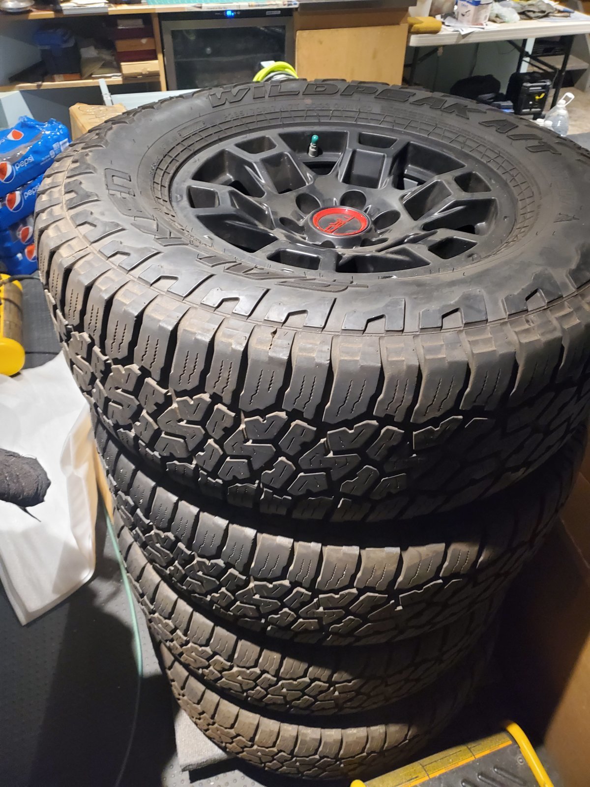

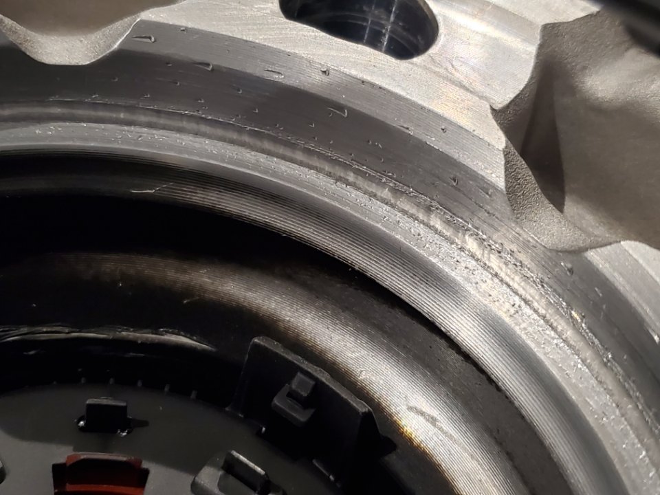

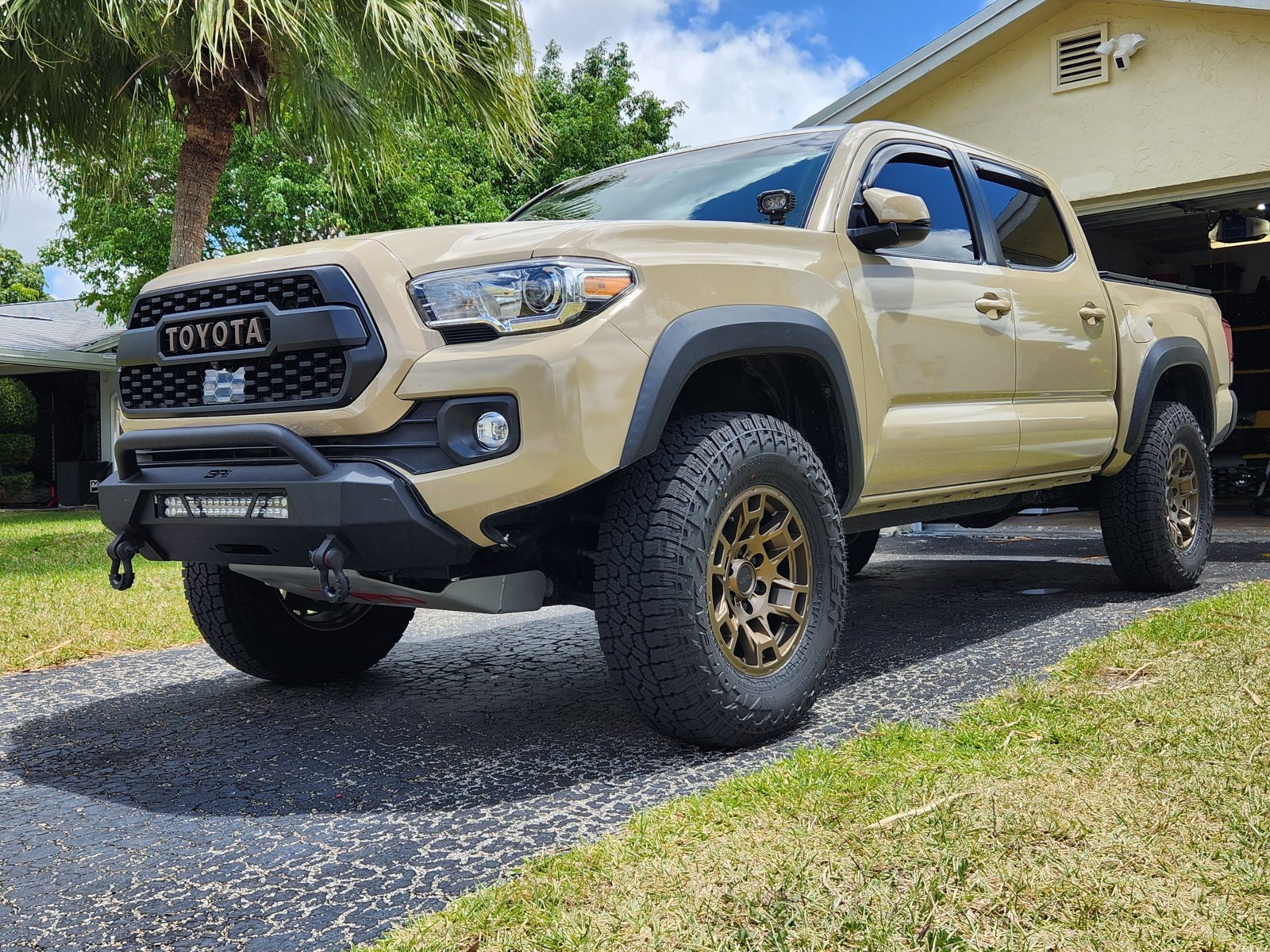

    Reviving this because I ran into a wobble issue. Noticed the gap and had difficulty taking the wheel off. Long story short I found this via a search, chamfered my hub just a touch, and was good to go. Thanks to all in the thread.
    Also threw on the trail edition tacoma grille. Amazon garnish works well so far.
    OEM 40th 4Runner wheels
    255/80/17 Falken Wildpeak AT4W E
    rybern and lastcall190 like this.

    Looks great man. I sort of suspect your not the only one that thought the OEM wheels fit without issue.
    How much lift is that?
