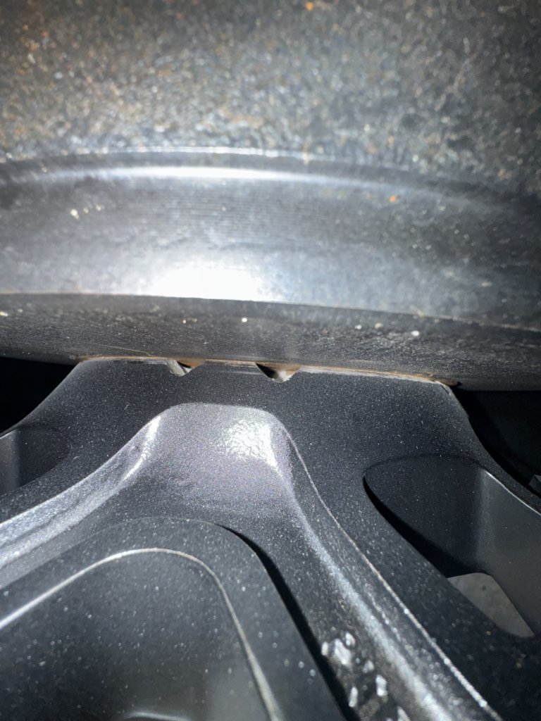

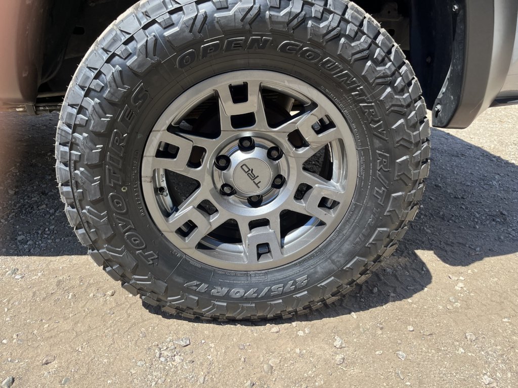

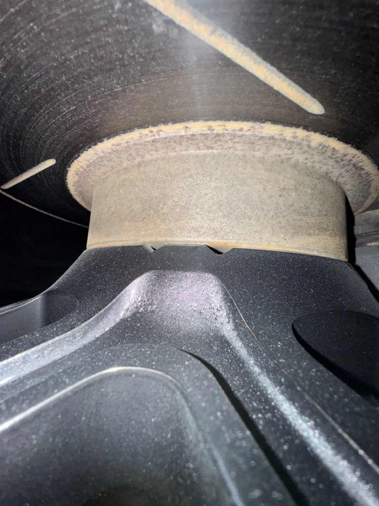

    Just installed a set of the new 4 Runner TRD Pro wheels PTR56-89210-F2's that I picked up with new Nitto tires. Yes the inner hub profile does hit the rear axle flange boss. I had gone back and forth between milling the wheels (already had tires installed and balanced) and grinding the axle flange boss.
    Finally chose to modify the axle flange boss as shown in the pictures. Followed the steps to have another person slowly rotate the opposite wheel while I had the grinder (used 80 grit) pad. After about 5 min on each wheel, and a couple of test fits with machinist blue to mark interference areas, they were perfect.
    This was on a 2015 2WD Prerunner with 6 lug (obviously) wheels. No issues up front.
    Came out very nice.

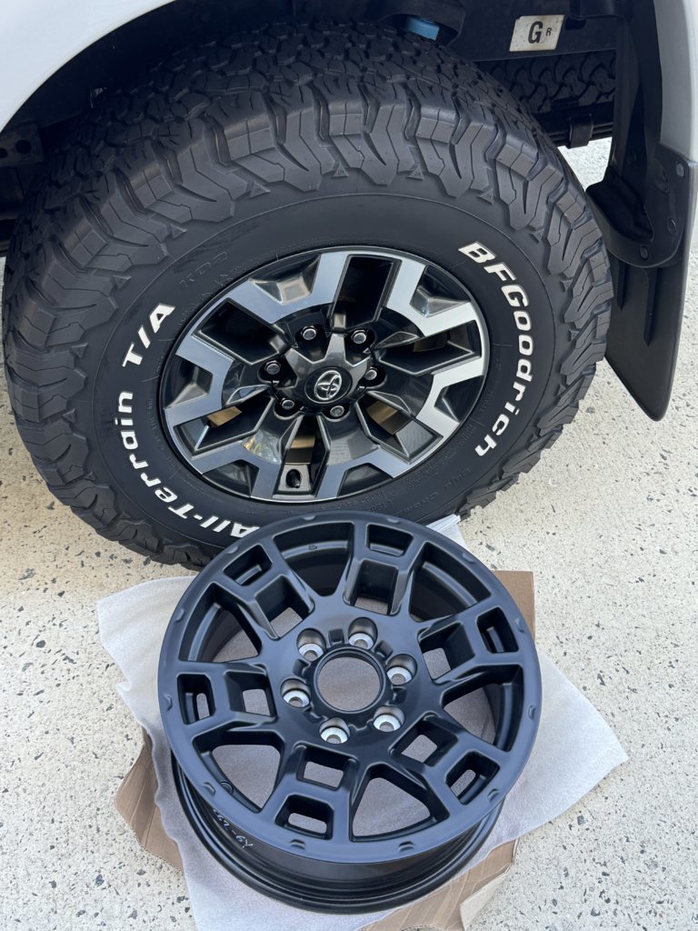

    Just installed them no modifications needed but I also have a 05
