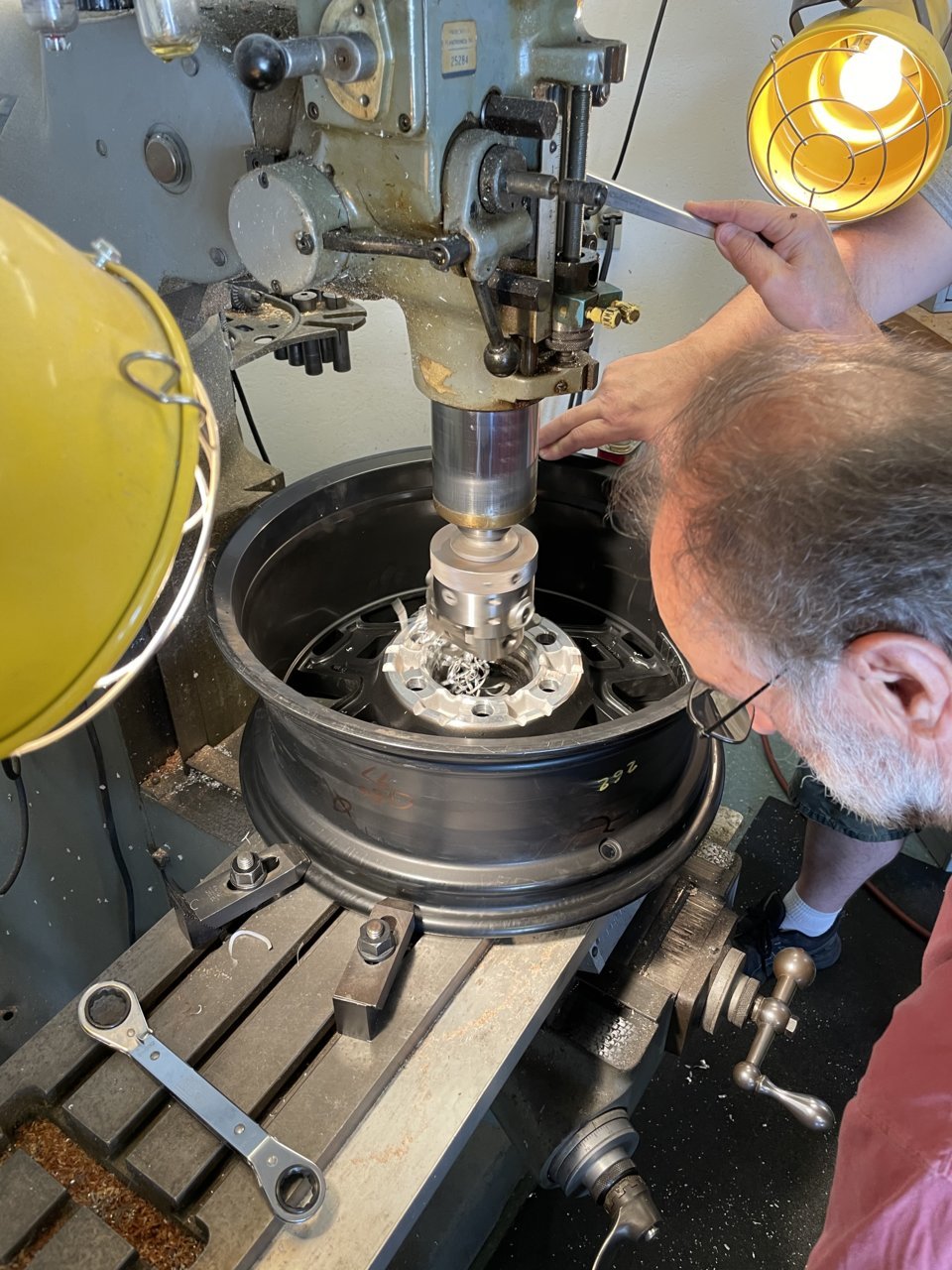

    Three millimeters deeper and fits like a glove.
