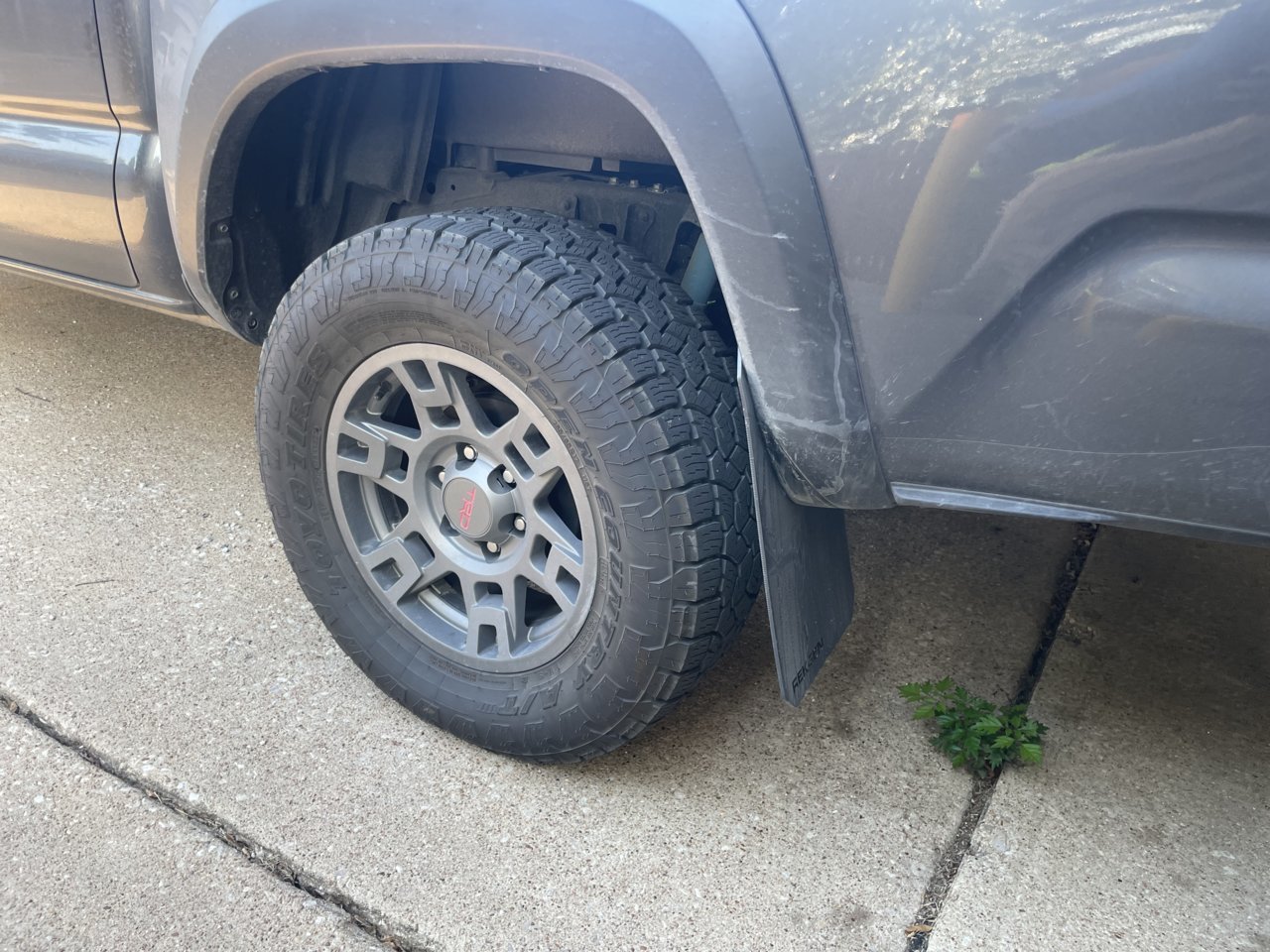

    Just found this thread. I’m not really sure what to think. I have (I believe) the older wheels which I’ll post a pic of. I believe they are the TRD Sema wheels. They came on my 2021 so either Toyota or the P.O. put them on. They are flush to the hubs and drums just fine once torqued.
    I went to do my rotation this weekend and I had to yank all but one of them off. So they are a tight fit to the hub bores. However, they install fine and safely. As for reinstall, I basically have to get the wheel up onto the hub, center the lug nuts in the wheel holes and then use the lug nuts slowly and evenly to pull the wheels onto the hub. It works fine but takes longer.
    The wheels I have:
    So even if I have the older style and not the 4Runner Pro ones, seems like fitment is still somewhat of an issue even though they work? I don’t mind yanking them off at tire rotation time but it’s a bit strange. I’m more concerned about the tire jocks installing the wheels properly next time they are in there.
    I looked at my rear axle shafts and they have the 90° corner, no chamfer, but I did not see a lip inside the wheel bore which is probably why the wheels sit flush against the brakes fine (vs the later wheels). So for me and my 21, I guess the only ‘problem’ is the tight fit and having to yank the wheels + install properly when working on them.
