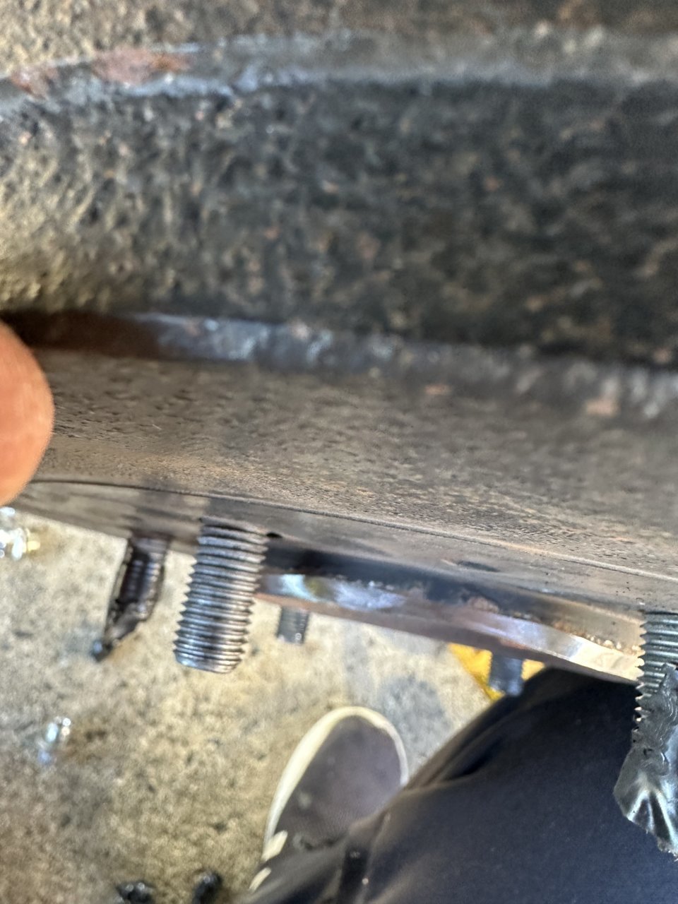

    Oh and I forgot to ask, but do you think a 4 or 4 1/2 metal grinding disc would be fine? That's just what I have on hand.

    I would use a 4.5” grinder but would recommend making the run to Home Depot or Lowe’s for a 4.5” flap disc for better use. You could try a grinding disc but I don’t think it will do what you want.

    Gotcha. I'm assuming a flap disc would get a cleaner edge on it then. I may have some sort of flap disc but I'd have to check. May give the grinding disc a try and if it's a no go, then off to home depot! I'll figure something out.

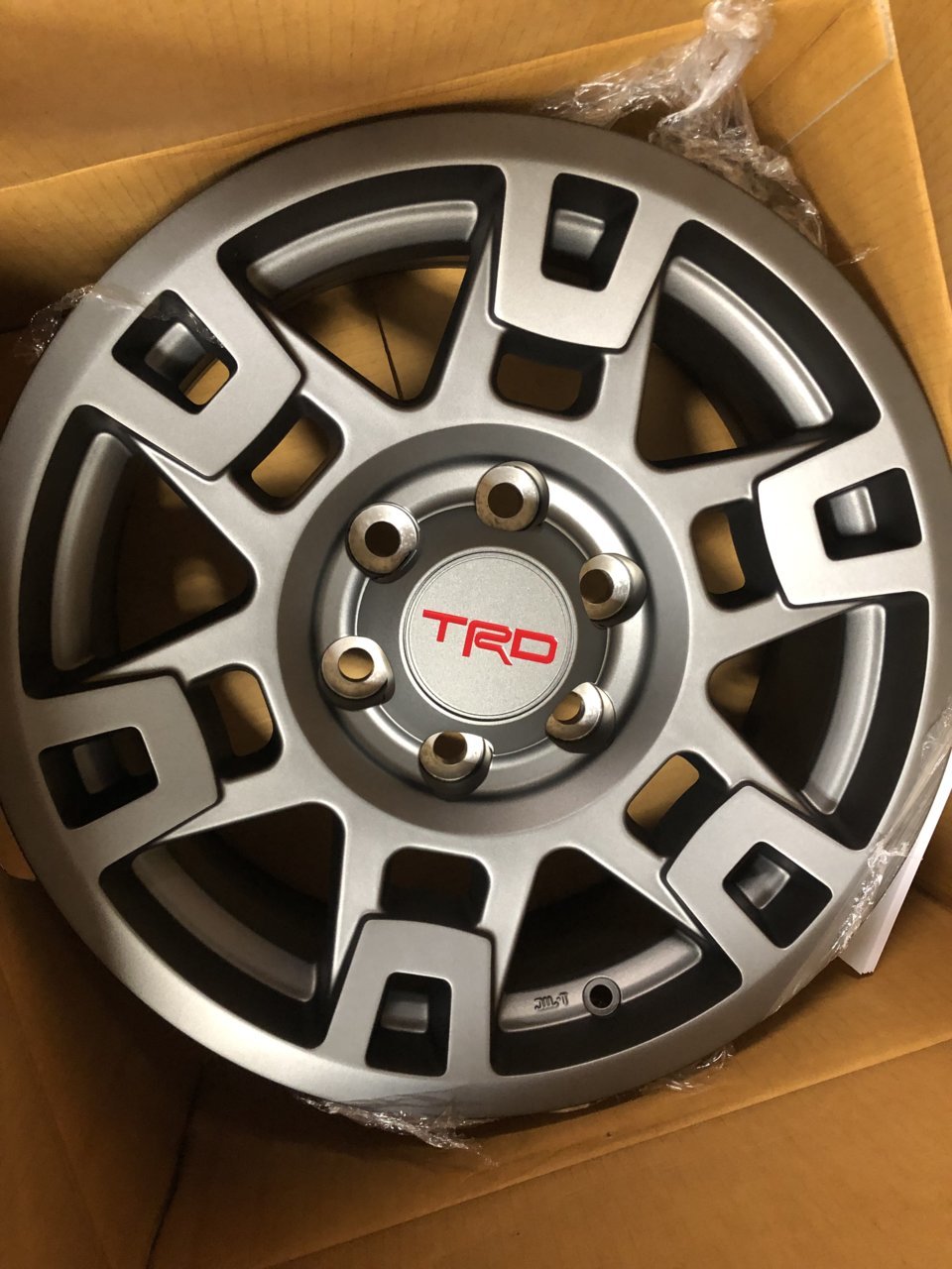

    63CEC61A-86F4-4CBB-8A2B-E144EFFBEA81.jpg 99FB2D32-1146-46F2-95EA-B5ACF85088FF.jpg Just bought these 17in Pro Wheels off of BAM. Any recommendations for some black lug nuts that would fit these? I’m planning on putting it in my 22 trd off road. Thanks for the help!

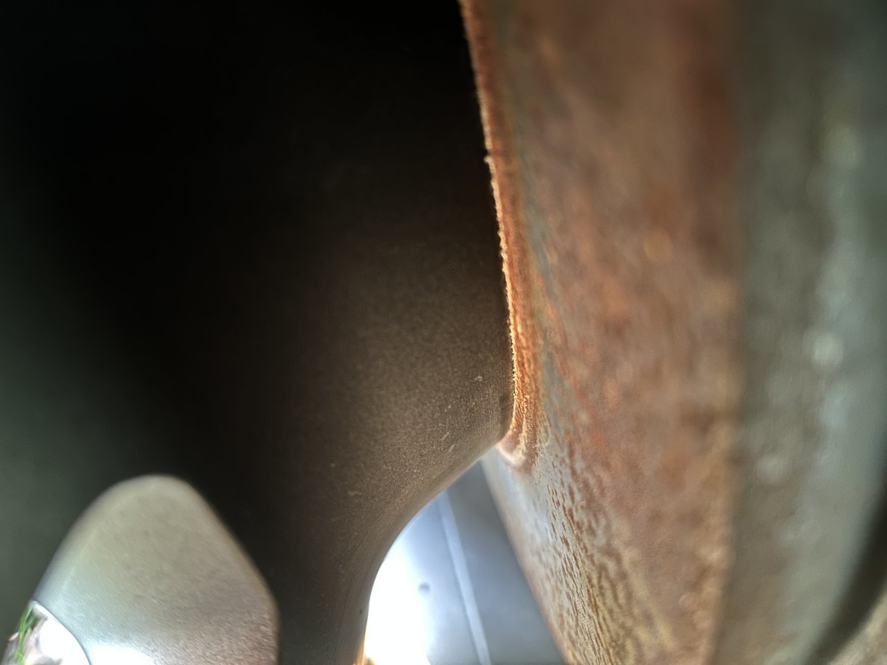

    I just checked my rear wheels for this gap. I didn’t see any gap on my set up but I have the wheels (see pics). Not sure what to do?

    You don’t have the wheels that have the issue.

    I’m guessing the newer model for the trd pro wheels only have the problem not the order model ones. I bought the order trd pro wheel ones because it it was the ones that came out with the matte gray color which I thought would go good for 22 lunar rock trd off road.

    Did I f up on that side view pic? There’s still plenty of mounting surface right? No reason to worry I hope? That’s the closest I ground to the hub and that’s what I did starting off before I got the hang of it.
