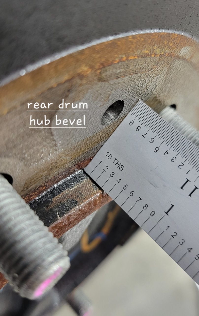

    It seemed to take a little more bevel than expected to get these wheels to fit but in full disclosure I'm a bit perfectionistic. I beveled until there was only .35" distance from the drum face to the edge of bevel. This matches the front hubs so what can it hurt.

    I too really do like these wheels and was dead set on them from the beginning. I bought the OEM wheels before my truck even came in, LOL.
    You have three choices:
    1. grind a bevel on the rear hub
    2. grind or machine the bore deeper on each wheel (most trouble)
    3. use some wheel spacers.
    I chose to bevel the rear hub:
    https://www.tacomaworld.com/threads/2023-mgm-trd-off-road-mildly-modded.787908/#post-28231540
    Do any one of the three and they should ride fine.
    Don't forget that APG makes what looks like the same wheel in a 17 x 8 that's a direct bolt on and can use the OEM center cap. I was so hung up on OEM that I didn't want to do that. But in hind site, I'd swap these for APG's now simply because the APG wheels are 8" wide(which is really what they should be for a 265 tire).
