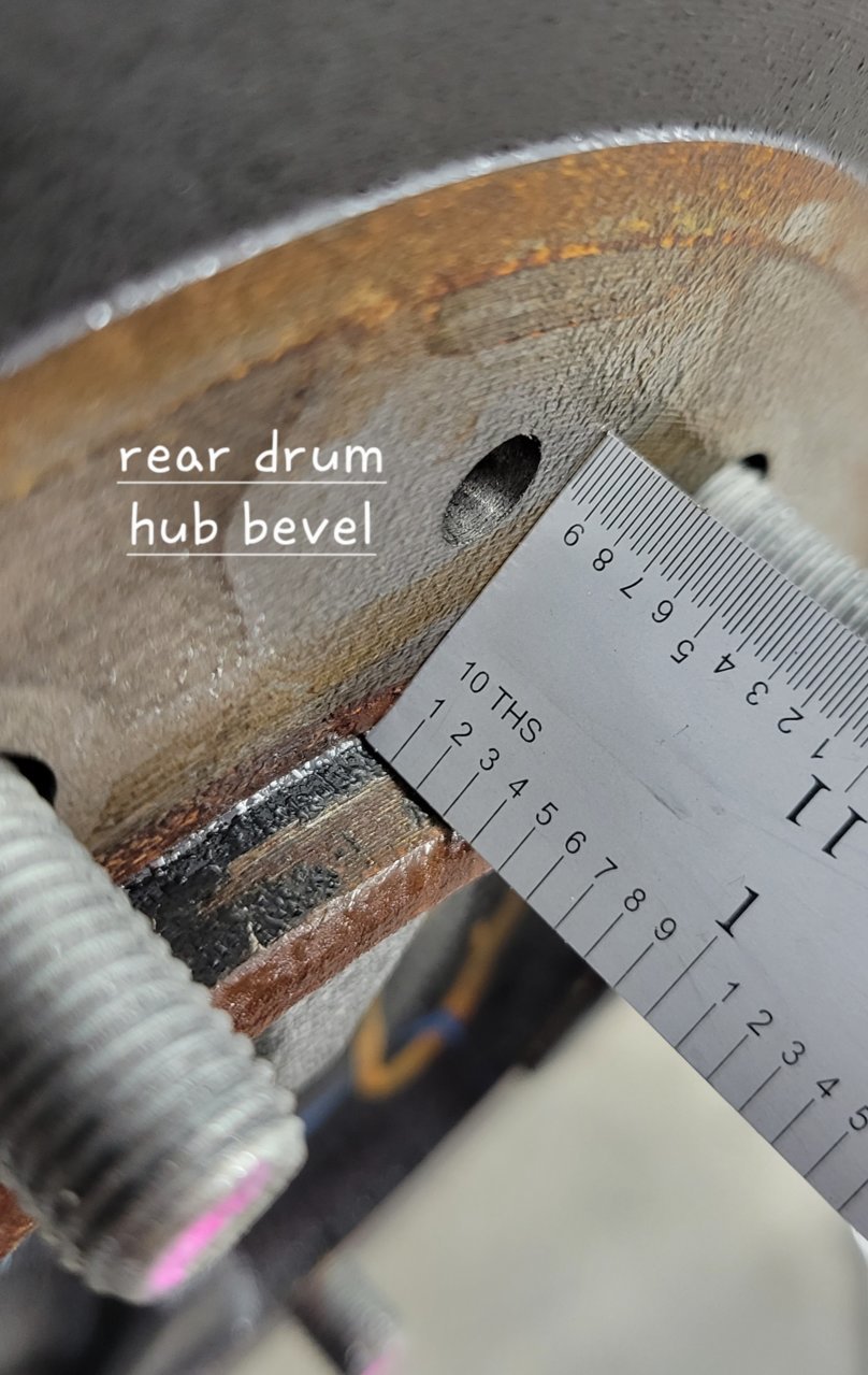

    Sorry to read this. It's not too late to sell them and buy APG's.
    Have you used an angle grinder before? I'm pretty talented with a 4.5" angle grinder and nicked the threads on the wheel studs. I ended up using 1/2" PEX cut the same length of the threads and it worked very well.
    I beveled until there was only .35" distance from the drum face to the edge of bevel. This bevel now provides the same shoulder length of the front hubs so what can it hurt.

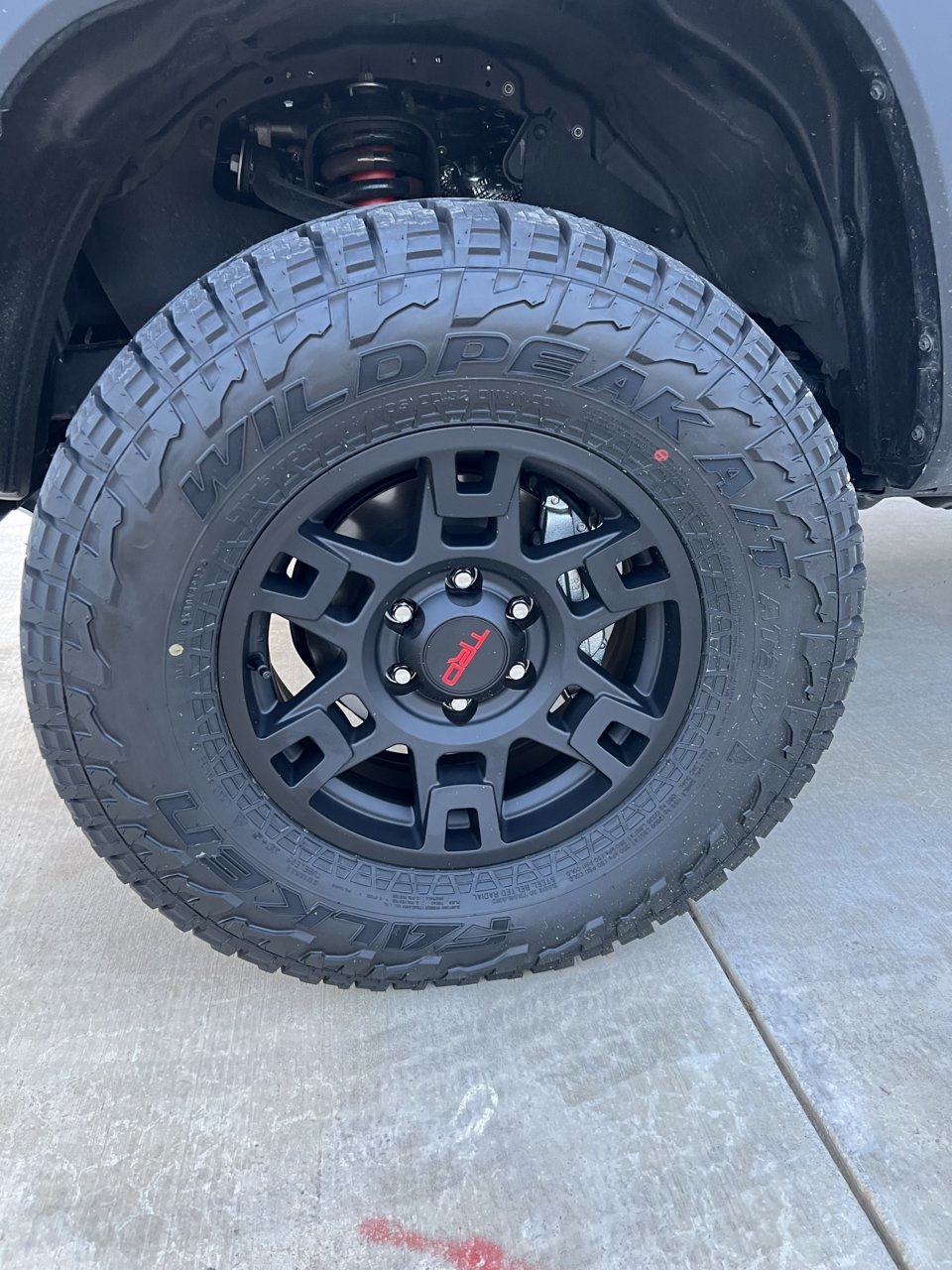

    TRD SEMA Wheels Falken Wildpeaks 265/70r17 DV8 Midbumper
    TLDR: Ended up taking them off and buying the ptr20-35110-bk
    So,
    I had the rims for only 4 days, went to the dealer today Monday cause Sunday they're closed, and even though i was still within the 7 day limit, they said that they couldn't take the rims because they were mounted and used, they didn't budge, even after explaining why the Rim doesn't work.
    Their words were that they didn't know they were different, because people come every day to buy them for Tacoma's, and the Service Manager even said that they even have mounted them for customers on their Tacomas inhouse. But that I was the first person to come back and submit a claim.
    They told that I either had to buy spacers or take the rims to a Machine Shop. Tried getting spacers but couldn't find, tried to get a local machine shop but the only one i found in my town the owner said that his machine is broken (and to be wary where i would take them to get worked on), and not very mechanically inclined to buff the Hub rings, so i bit the bullet and bought the ptr20-35110-bk from another dealer.
    The other dealer told me "yeah, we get a lot of customers come from that dealership", I can see why now.
    Now Im sitting on the 2021's getting a lot of calls from Marketplace cause Im selling them at a loss. IMG_5538.HEIC.jpg
