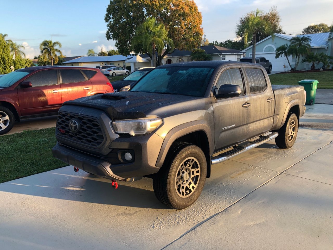

    Nope, just freshly washed in the closeup pic.

    2023TRDOffroad
    2023TRDOffroad Well-Known Member
    Jan 26, 2023
    #416450
    87
    California
    ‘23 DCSB TRD Off-Road 4x4
    Idk man, up to you. If I was you I’d just buy the PTR20-35110-BK and be done with it. They have a confirmed fit. My buddy bought the grey ones of the same model and they fit fine too.

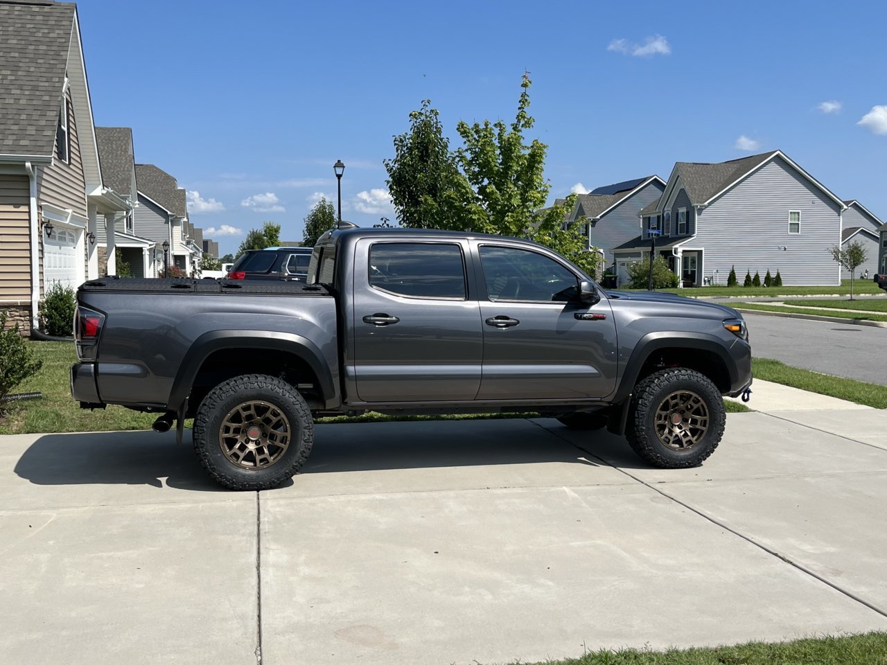

    Mikro
    Mikro Well-Known Member
    Oct 11, 2019
    #307708
    170
    2020 MGM TRD Pro
    I just got a set of Bronze FSW wheels in the 4Runner style. 17x8.5 and 0 offset. So far so good.

    rybern Well-Known Member
    Apr 3, 2017
    #215281
    2,347
    N Alabama
    2023 TRD OR & 2000 SR5
    5100's & 3AAL, 265/70r17 Toyo AT3
    Yep, that's the ones I was thinking of. OEM caps fit too. The FSW wheels that Mikro posted look nice too.

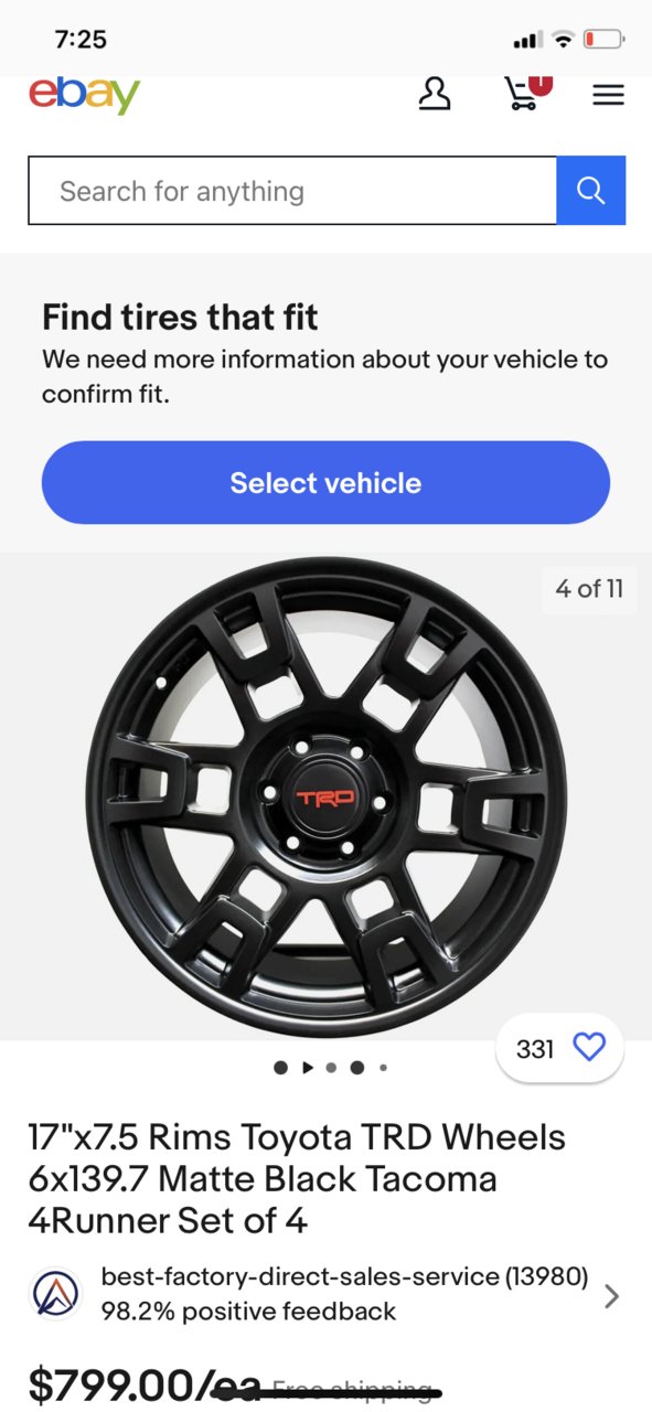

    eBay best-factory-.. is the best deal I found, $800 free shipping. But I wonder why it says 7.5” wide when I thought they are supposed to be 7” wide.
    Can anyone please recommend a website that will send them with tires mounted and balanced? I think I’ll get them with 255/80R17 tires. THANKS

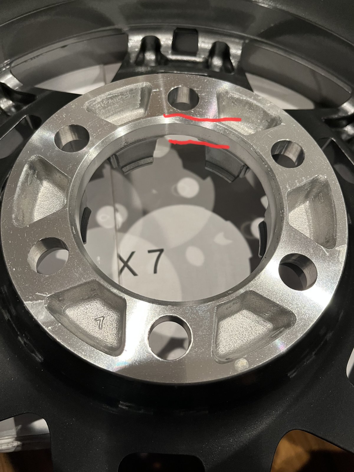

    I read through all the posts. Honestly I’m confused. I have the gloss gunmetal SEMA style OEM wheels (part # PTR20-35110-G4) and while I can squeeze them on the front I simply couldn’t get the rears to sit flush even with considerable force (I didn’t try pulling tight with the lug nuts). I have a 2020 TRD Off Road and these wheels came on the 2020 4Runners I believe but they look just like the SEMA wheels. My truck is very low miles and garage kept so hardly any corrosion on the hub (none actually).
    According to the posts here they’re supposed to fit because they’re not the 2021 style but they don’t. Do they have to literally be pounded on the rear? Could it be the gloss gunmetal is different than the matte finishes?

    rybern

    That's odd. Post a picture of the backside of the hub. I'm curious how much chamfer it has and would like to see if there is any overspray. I had some OEM Vette wheels powder coated two years ago and when I got them back they wouldn't fit on the car due to build up inside the hubs.

    #323755
    84
    Tom
    2020 Tacoma DCSB OR
    Sure, here’s a picture. No overspray at all. I felt the insides of all bores and everything is smooth except there was some minor material that came off when I tried to press on the rear.

    rybern

    N Alabama
    Yep, the bores look good. Measure the depth of the counterbore on the wheel and compare that to the how far the hub sticks out. This may help determine if the issue is related to the depth of the bore or the bore diameter itself.
    Either way, this is very odd.... just trying to help pinpoint the issue.

    20thumper Well-Known Member
    Apr 3, 2020
    #323755
    84
    Tom
    2020 Tacoma DCSB OR
    Good idea. I’ll try to get the wheel off again today. A bit hard as I’m awaiting hip replacement surgery but I can manage.

    Apr 3, 2020
    #323755
    84
    Tom
    2020 Tacoma DCSB OR
    I test fit the other 3 wheels (not sure why that didn’t occur to me before). The other 3 are very tight but they fit. It appears one was possibly machined incorrectly. I ordered these over a year ago. Not too expensive, I’ll just order another wheel.
