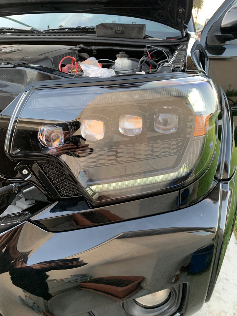

    I have a Huge problem..i jus received the New AlphaRex Pro Series headlights from TacomaBeast.
    It was pretty simple to install..looks awesome..wiring seemed really straight forward..sucked that there was no instructions at all..

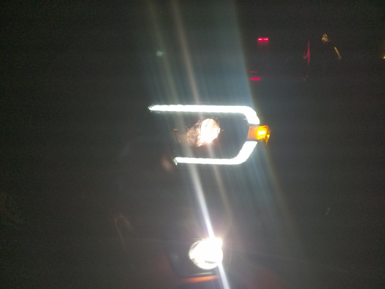

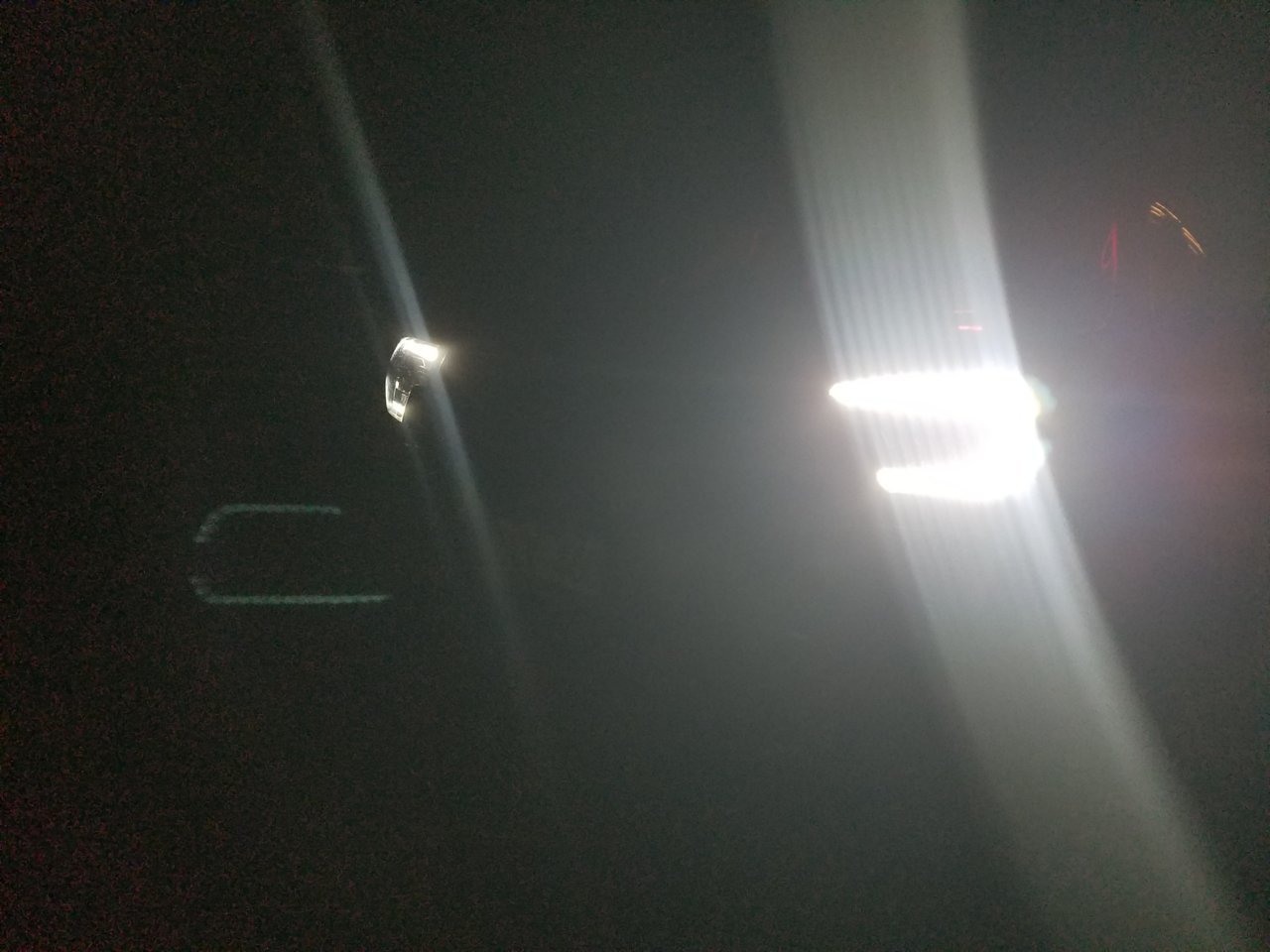

    My DRL barely lights up..some places are brighter ..when I try to use my turn signals on either side..BOTH sides hyper flash..and aren't changing to the amber color..just straight white .. it also makes my RPM cluster lights get brighter and dimmer with each blink! the next problem is when I turn on the side markers for evening driving . .NOTHING works at all...the DRL that surround the headlight turns off completely. when I finally turn on the headlights..only the headlights work..
    I don't know what the heck is going on..i feel like it's wired wrong internally..did anybody else purchase these lights for thier 2015 Tacoma and have problems too???20210529_193653.jpg

    Wiring is pretty much straight forward as you can get..the only thing I wasn't sure about was the small fuse which needed to be piggybacked into the fusebox..i uses the 15amp IGN..port..other than that..red wire straight to battery positive ...black wire straight to battery negative poles..

    This is what I get. They go off once I turn in my headlights on.

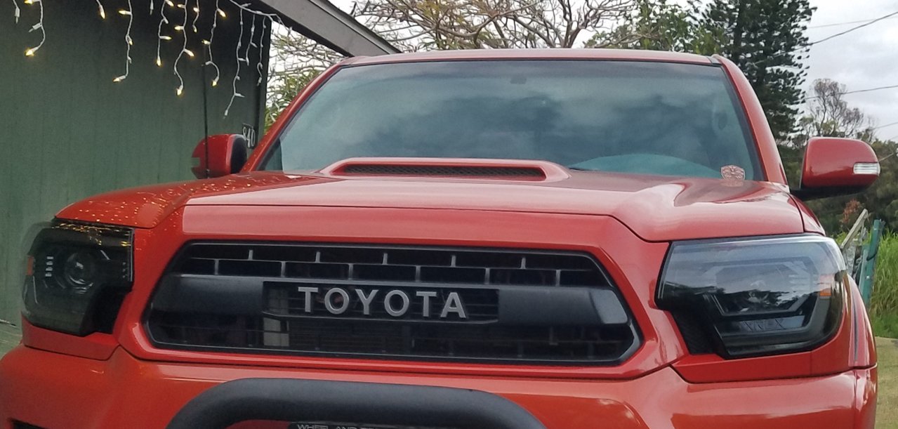

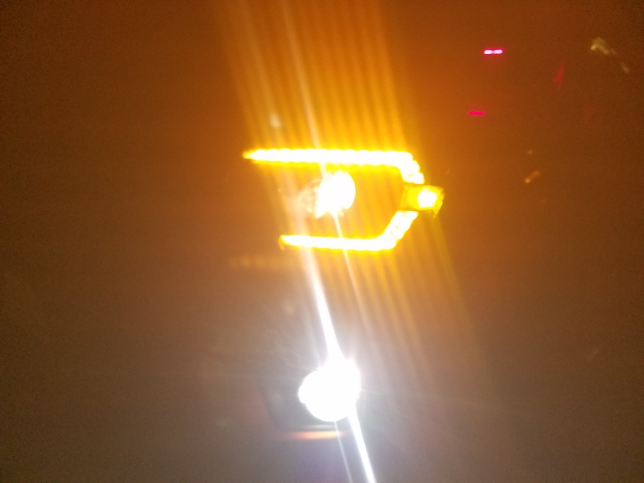

    it took me about 30 mins to repin..wasnt too hard..jus put the black pin in the middle the yellow wire pin where the black was on BOTH headlights and the lights are CHERRY! looks great..esp for being China made..works well too..thankyou my Braddahs for the info and support...STILL really sucks for how much you pay and the harness is pinned wrong..AlphaRex better get their Sh*t straightened out. Gnite and Aloha

    Just DRLs...and then with lights on using blinker
